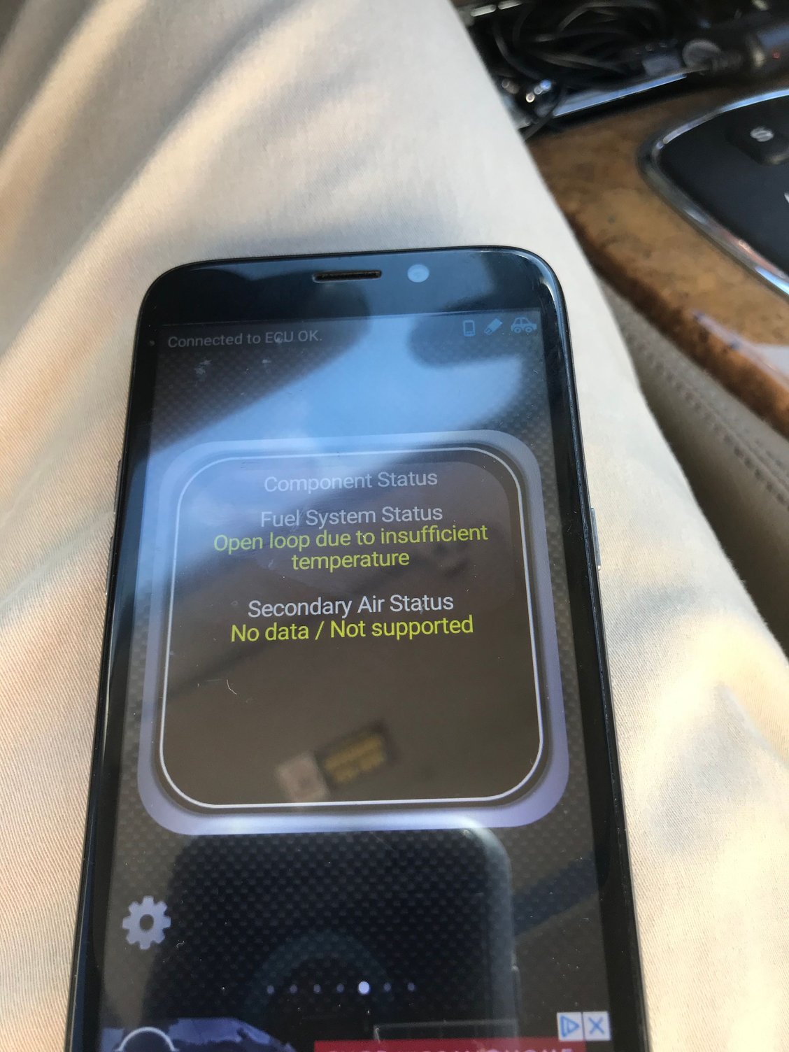

Finally got the torque lite app to work on this old android phone. I ordered the WiFi elm327, but haven’t received it yet. What’s the remedy for the open loop just a simple temperature sensor?

If it is showing values which are wrong, yes.
(Very rare.)

Originally Posted by 03BlueJagV8
What’s the remedy for the open loop…
The “remedy” is to figure out why the engine won’t start, correct that, and then warm up the engine.
What you’re seeing is not necessarily a fault. It’s a normal status for a cold engine. It would be a problem if the engine was warm, but that’s not the case.
Even if that was a fault, it would not prevent the engine from starting.

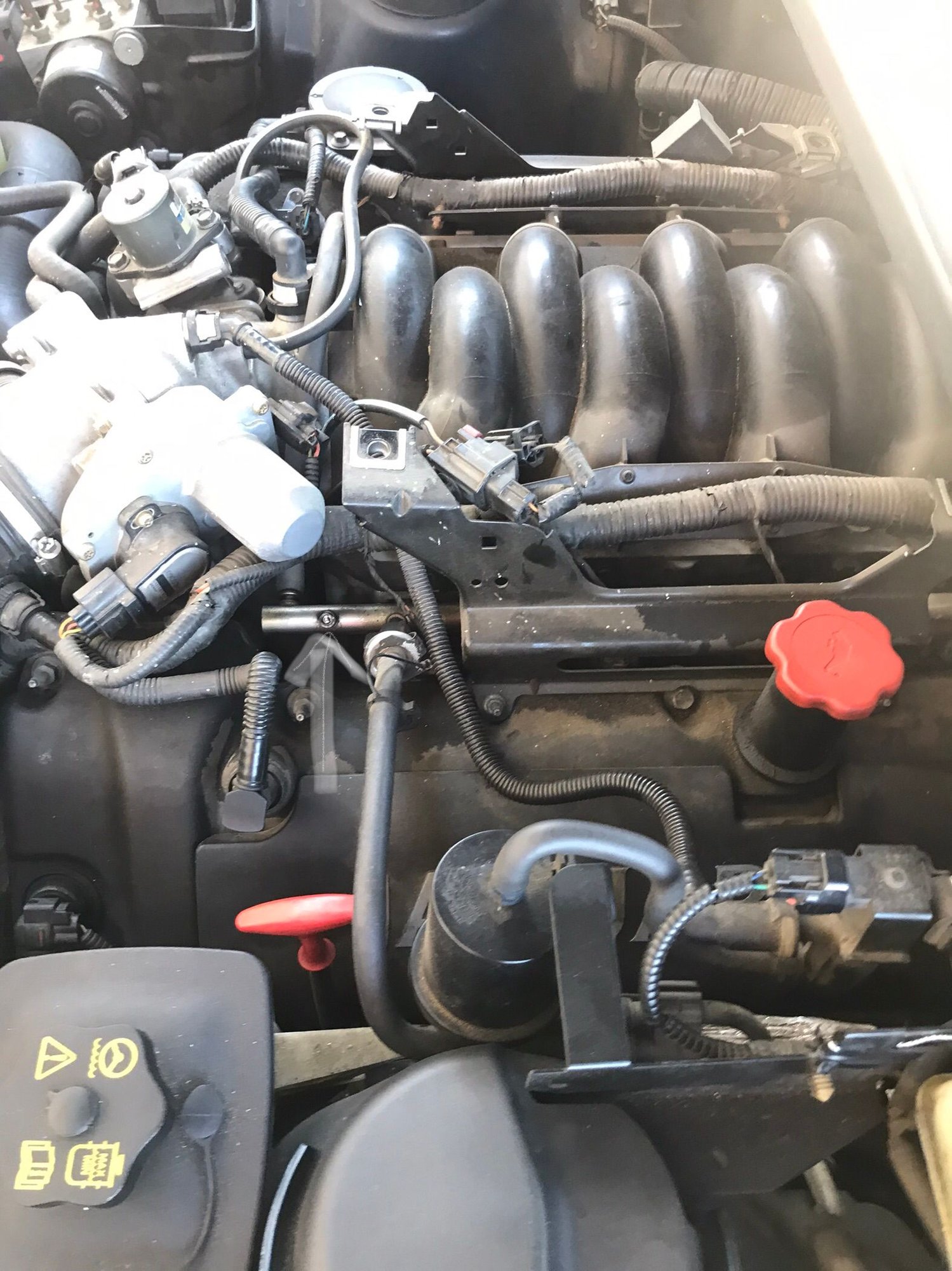

Is this the Schrader valve? Is this another way to monitor fuel pressure?
