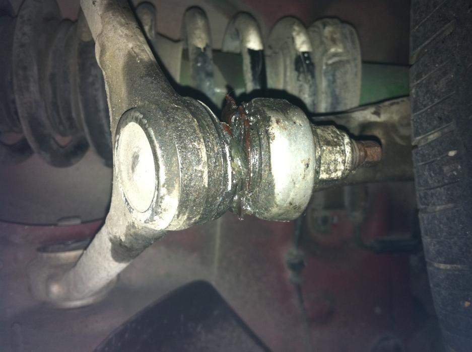

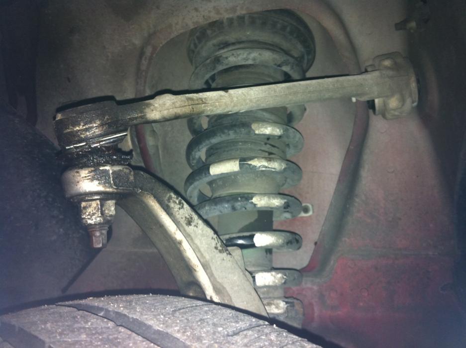

Does anyone know how to fix this issue? Im driving a 2000 s-type. Any time the car rocks over a bump or if I turn the steering wheel left or right, there is a load nasty high pich noise the comes from my right wheel. There seems to be a part that is worn-out. here are some pictures from what i think is making the noise.

Based on your pictures that ball joint is toast. The rubber boot is torn or gone altogether. You can confirm this is the source of the noise by jacking up the wheel and putting a pry bar between the upper arm and the vertical link. If there is any movement it confirms that the ball joint is shot.
It also appears that your shock is leaking. How many miles on your car?

The lower joints is probably the noise you are hearing. The upper joints don't make noise. But I would do the vertical link and the upper arms. I think you can get the lower ball joints with having to buy the the vertical links. But I don't think you can get the upper joints seperate from the upper control arm. I would have the whole front suspension checked to see what else is bad. I bet the toe link adjuster boots in the rear are torn up, and the sway bar link boots torn to. Those upper arms are expensive. I would shop around online. They should be the same as a lincoln Ls?

The upper can squeak just like the lowers do. The upper pivots when the spindle is turned just like the lowers. By the looks of that pic your uppers are shot. If you dont want to spend too much I would start by replacing those, if you are wrenching on it yourself, since they are the most visibly worn out. I had the same problem on an Audi I had with the squeaking and it was only the uppers that were shot but since they sell all the control arms in a kit I replaced all of them (there are 4 arms per side on an Audi, 2 upper, 2 lower).
