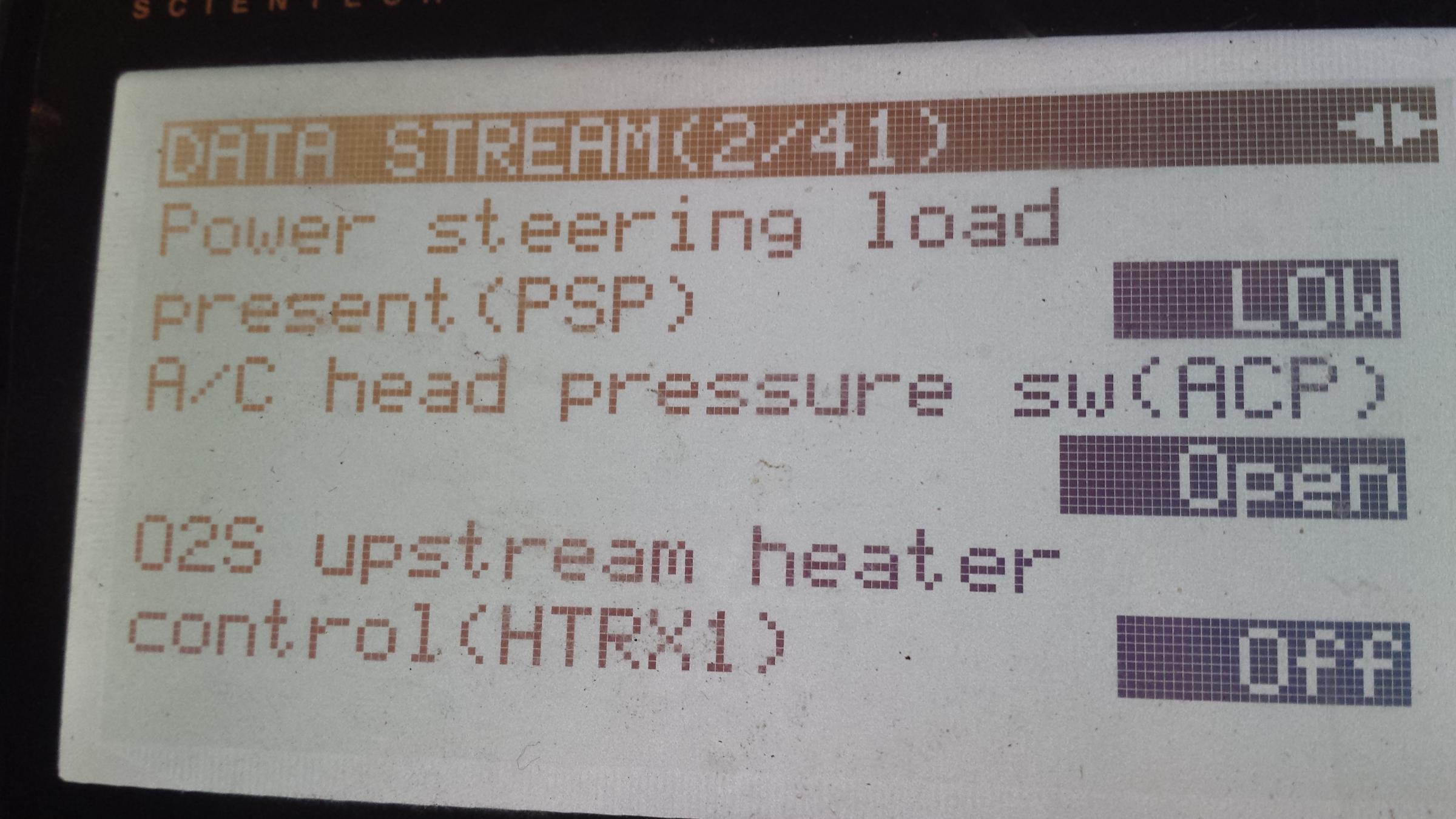

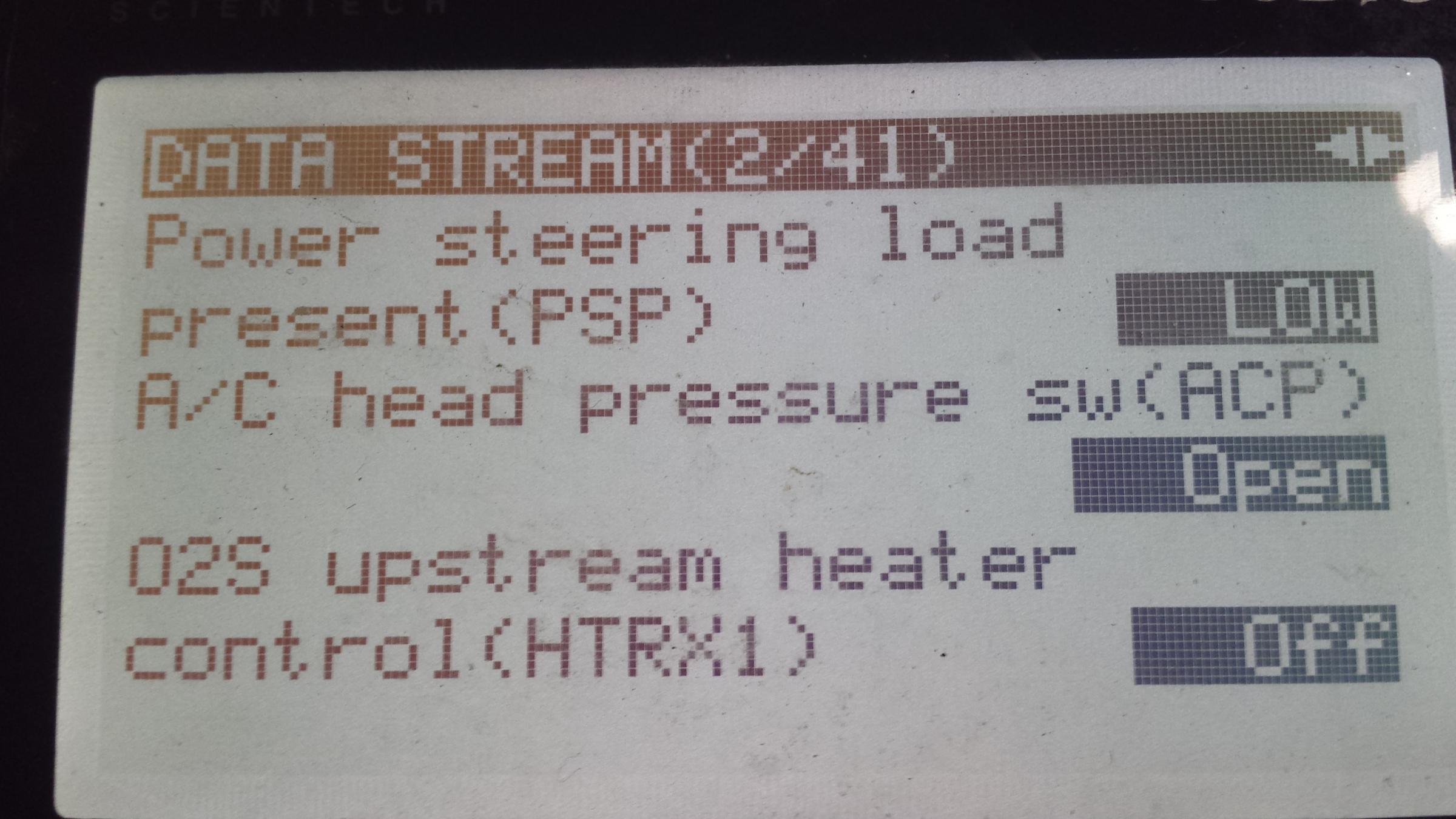

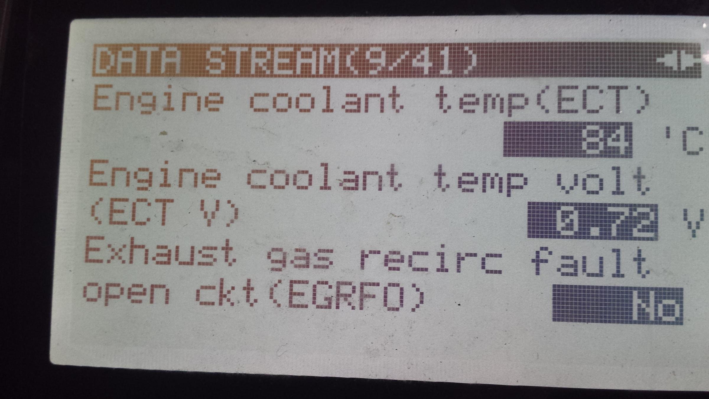

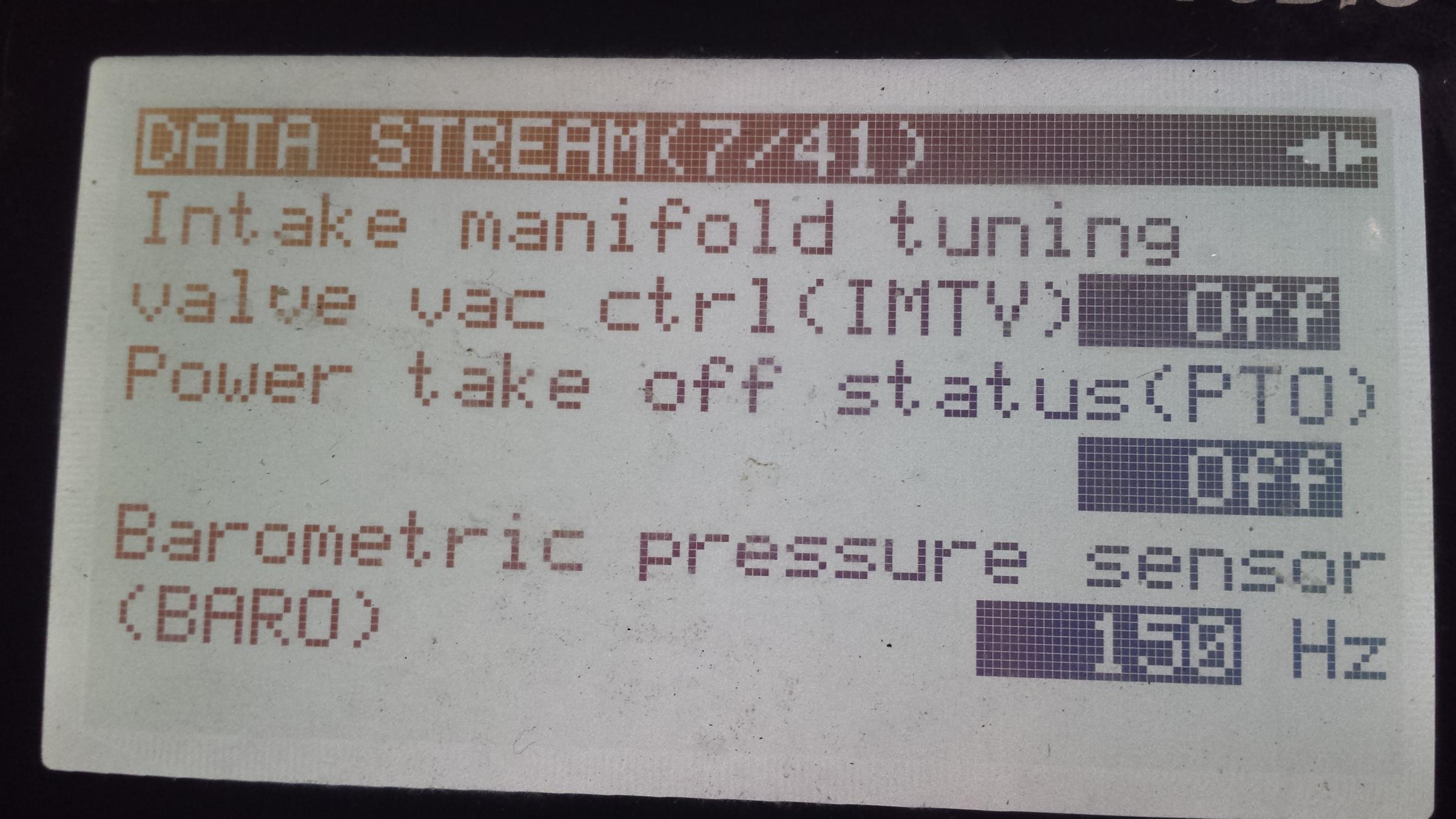

The new coils and spark plugs eliminated the miss. Curiously, there is an error code on the bank 2 LTFT. As my Jag is running near perfect, I've taken photos all the outputs from my scanner. Could it be useful for others to upload them?
Any ideas on the error code?
Attached Thumbnails OBDII Data Streaming..What's normal?-20140706_183802.jpg   OBDII Data Streaming..What's normal?-20140706_183822.jpg   OBDII Data Streaming..What's normal?-20140706_184937.jpg   OBDII Data Streaming..What's normal?-20140706_184952.jpg   OBDII Data Streaming..What's normal?-20140706_185001.jpg
OBDII Data Streaming..What's normal?-20140706_185015.jpg   OBDII Data Streaming..What's normal?-20140706_185023.jpg   OBDII Data Streaming..What's normal?-20140706_185031.jpg   OBDII Data Streaming..What's normal?-20140706_185040.jpg   OBDII Data Streaming..What's normal?-20140706_185049.jpg
OBDII Data Streaming..What's normal?-20140706_185101.jpg   OBDII Data Streaming..What's normal?-20140706_185110.jpg
