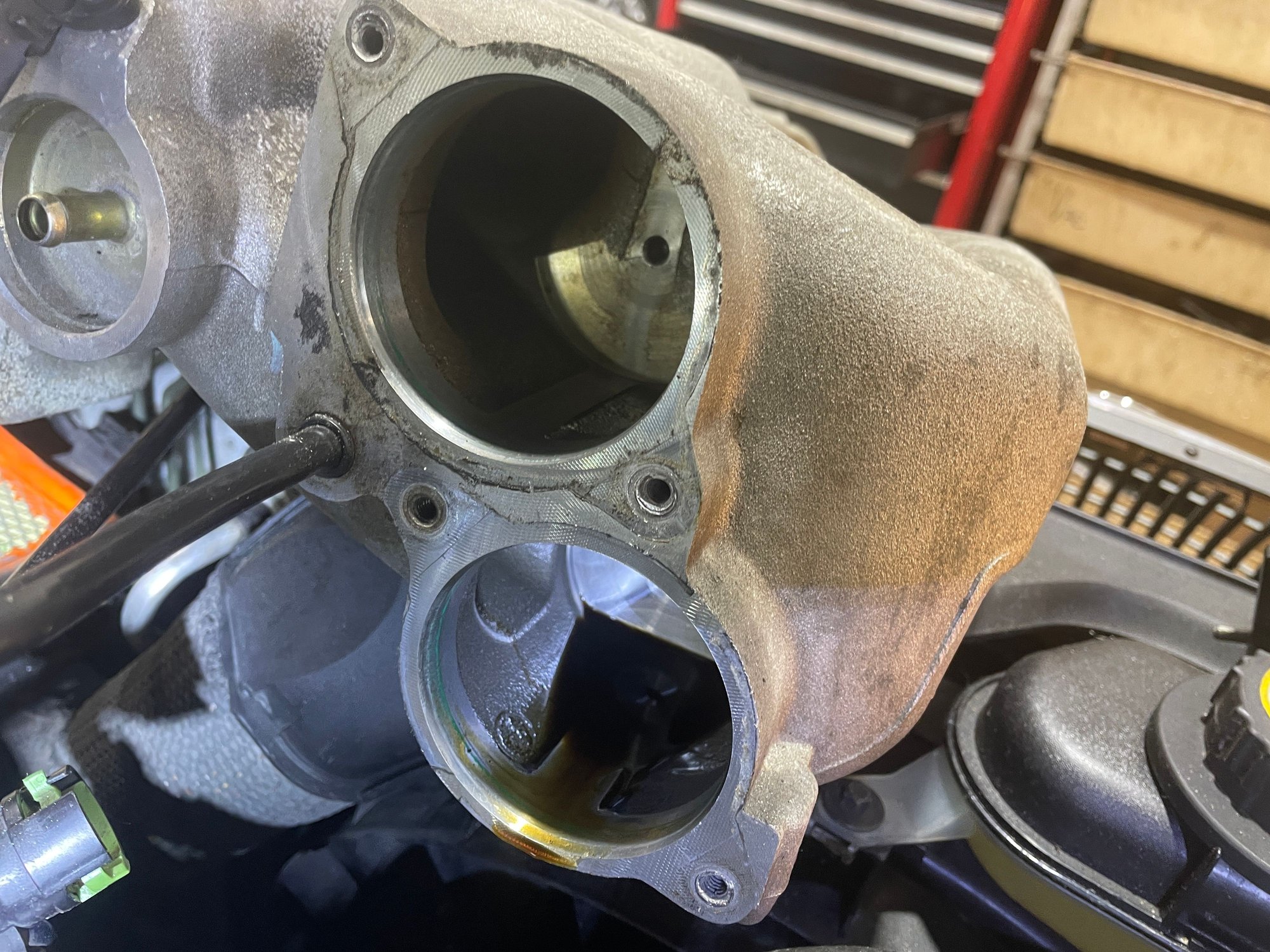

Hello,
I have the upper and lower intake off, attempting to reseal everything to solve a code.
I was surprised to find a lot of oil behind the lower IMT valves.
Then I was researching here, and read Joyce'sJags post
https://www.jaguarforums.com/forum/s...ics-faq-32135/
and they found oil there too. Do we both have a PVC issue, or is this normal? My 2006 does not have the black box catch can under the lower intake, only has 2 hoses and 1 valve.
The IMT's have the new green seals, and I'll do the plugs.
Is the oil normal?
Thanks,
Rob

My '02 V6 had oil collected by the IMT valves, too. The plenum is a different design, but still the same end result. Doesn't seem to be causing any trouble.

Think it is pretty common........happens on the X-Type 2.1, 2.5 and 3.0 engines too.
Even my 4.2 XJ V8 gives the occasional blue puff at start up (once every 6-8 weeks) which I think is just some condensate build up getting occasionally pulled through.
A catch can generally solves the build up if you are concerned.

Thank you Mark and Carl.
I have new gaskets coming, and will put this back together.
Cheers,
Rob
