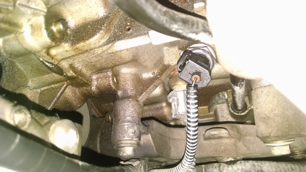

Thanks much, Karl! This entry allowed me to get a shot of it on my second try:
https://www.jaguarforums.com/forum/s...26/#post608834
Now if only my hands were as thin as my phone.....
BTW, don't know how I missed your thread, I found a couple using search a few weeks ago....or months, now I guess it was, but everything I found on it just described the same problem (Oil P warning at idle on warm engine) and claimed success with a new switch.....didn't find one on actually replacing it. I'll probably try the reservoir route, rather than removing the pump..at least for a first pass...have had that out a few years ago when I swapped reservoirs between the 03 and the 05.
Abonano...yeah, that is of course the proper way to proceed...but I haven't yet figured out how to check it with a direct-reading mechanical gauge when I don't know where the switch/sender port is located....

As already mentioned, I had the air box out. That'd be the first step. I don't think you can accomplish oil pressure switch renewal with it in-place.
Here we are, prepared to drain the power steering reservoir through the forward, small-diameter hose:
One spring clamp, then significant grunting, pulling and twisting and eventually it will break free. Careful to make sure you apply only axial loads, nothing in bending, to the hose/nipple. It's a plastic res, after all....
Now getcha 8mm socket (I found a shorty best for the bolt on the inboard fenderwell) and remove the two fixing bolts. No need for a suitable container as the fixing bolts are retained within the iso-mounts that cling tenaciously to the reservior.
I didn't mess with the larger diameter hose on the bottom of the reservoir...wasn't necessary. Just lay it over out of the way.
Now you are afforded room to reach in and disconnect the electrical by feel. Find the tab, press and pull aft.

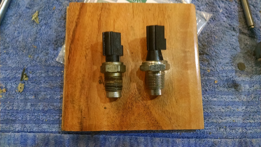

I went at it with a 24mm socket because that is what fit my Beck-Arnley replacement. No joy. Fiddled with it a bit and determined the original requires a 21mm socket. You'll need a collection of extensions, wobbles, and universals. Well, with a little more effort and contortions, you may be able to do it with a straight extension of exact (but unknown) length.
Twist the new one in..I torqued it to just past "feels about right" to "ain't broke yet." after a generous application of anti-seize on the threads. Plug in the electrical connector.
Remount your reservoir. Reconnect the small hose. Top it up. Remount the air box (don't forget to plug in your MAF) and you are good to go. I sourced this one from Amazon:Beck Arnley 201-1920 Oil Pressure Switch with Light I'm still looking for the light that should've been included according to the title/description ;-)

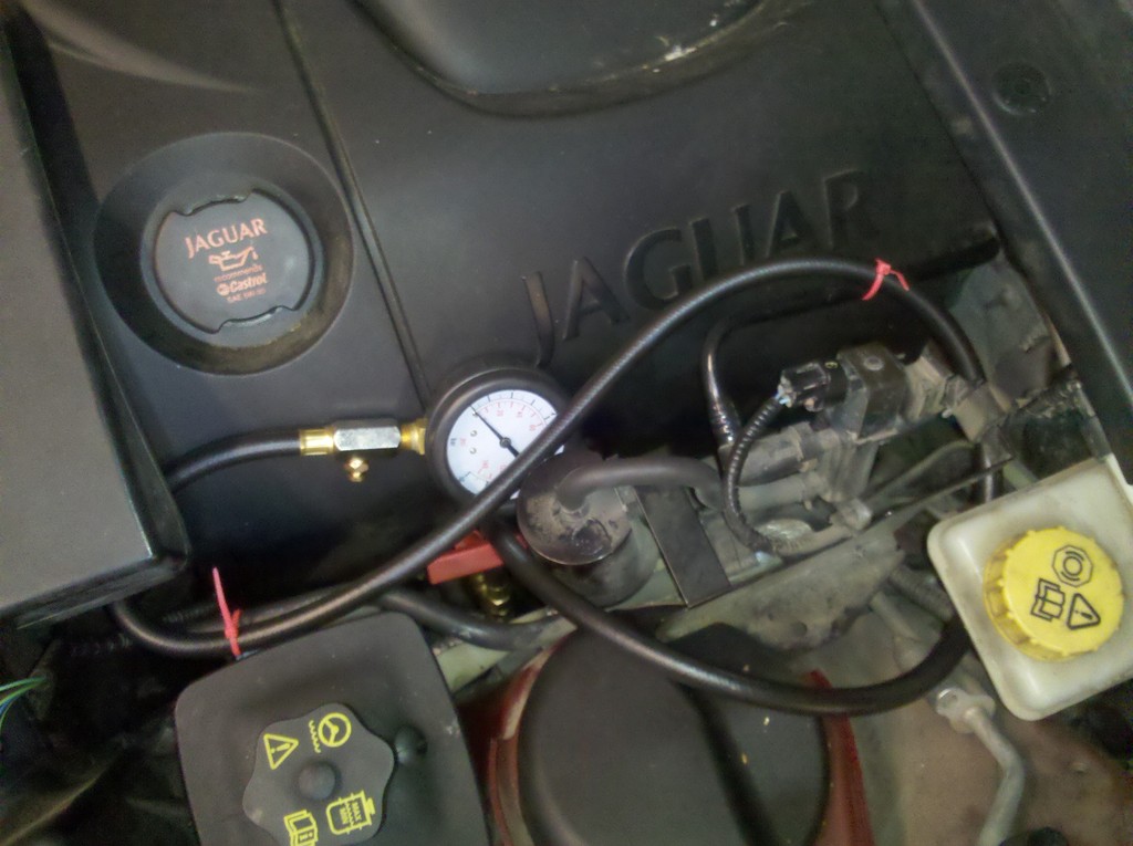

So I parked it and ordered this:

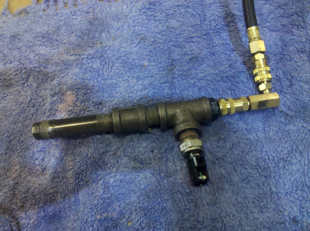

After considerable futzing about I managed to string together the following bits of 3/8" black iron plumbing to allow fitment of both the gauge and the warning light: from the engine block: 3" nipple, union, close nipple, tee.
Although fitment of the gauge alone would've been much easier, my interest was not so much "Oil pressure value at idle" as it was "Oil pressure value at idle while warning light lit!"
I fit the gauge adapter in the the tee opposite the nipples, then the gauge kit quick-connect 90 deg fitting, then the gauge hose quick-connect. I fit the switch in the vertical port of the tee. FWIW, I fit the old pressure-switch which seemed to be more likely to exhibit the problem. I've spent several days with it driving locally (didn't want to make the run to the metroplex with all that hose coiled up under the bonnet) but getting it well up to operating temp and then idling for sufficient time for recurrence, but have been unable to duplicate the problem.
Last night I stripped off the gauge apparatus and re-fit the new pressure switch. I'll turn it back over to management for her commute to/from work which is only 5 mi down the road with scant idle time and see if she reports the return of the warning light. While instrumented, I regularly observed 80 psi at idle after cold start, and 18-20 psi at hot idle. Lowest I ever observed was 18 psi.
I purchased 3/8" nipples in 1/2" increments up to 4 1/2". None were long enough to clear the head enough to allow installation of the tee. However, with the arrangement ultimately chosen, I had only enough room between tee and structure to fit the 90 deg. fitting. Wasn't enough room to skip the 90 and just use the hose.
During set-up/testing, I had occasion to access the oil pressure port often enough that I figured out there was no need to drain the PAS reservoir. Pull the air-box, Remove two fixing bolts from the PAS res, and lay it over, forward, where the air box was, hoses still connected, and you can access the oil port for switch change or such other schemes as you may devise.

After that, I fit the mechanical pressure gauge under the bonnet and never saw anything much below 20 psi, maybe 18 once or twice. I believe the pressure switch trips at 8 psi, but unsure of that. No recurrences since I refit the new switch.
