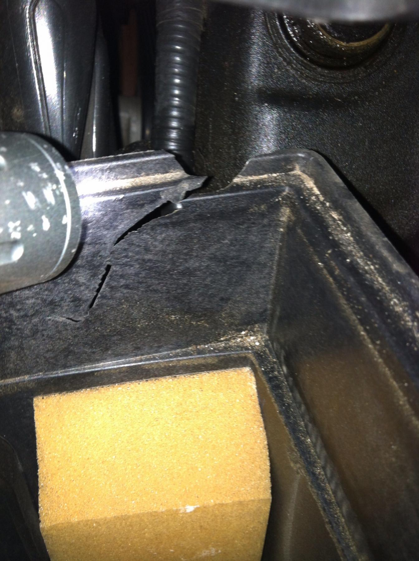

I installed a new MAF sensor. While doing so I checked out the air box and discovered the damage in the photo to the lower air box assembly. I'm sure it was damaged by the local garage that changed the filter. They didn't say a word. Could this cause a lean condition? I suspect so but I'm asking for a second opinion. Here are my latest LT FTRM 1/2 readings at idle and 2500 revs.
1 at idle. 7.0 At 2500 revs. 4.6
2. At idle 5.4 At 2500 revs 5.4
MAF. .528 1.83

No it's still metered air but it is sucking in hot engine compartment air instead of thru the factory fresh air setup. Should not set a code but definitely fix it.
It's a shame when the repair guy does more damage than he fixes!

after MAF sensor replaced and air box temporarily repaired with metal 3m tape, no pending codes set after 25 mile run.

Made second trip and no codes either set or pending.

Probably found and fixed (at least for now) the air leak. You'll know in time. Easiest way to check now is to do those LTFT checks.

BTW, the o-ring on the MAF sensor was old and had shrunk. Not sure it was a good seal. This problem came about immediately following a 80,000 mile check and oil change.
