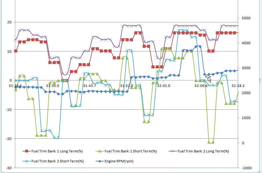

Both short trims jump from -20 to +20 or so. You probably have bad MAF.
Remove it and clean with cheapest brake cleaner.
+ 15 short trim at high RPM can be dropping fuel pressure, bad fuel pump/regulator. Fuel pressure should be on scanner.
Both sides trims are very similar so you're looking at something common to both banks.
They don't drop from biggish +ve (at idle) to near 0 (at 2500) so not a typical air leak. (Likely not an air leak at all, unless you've 2 faults.)
Bad MAF (dirty/etc) or fuel pressure - yep good thinking.
I don't know if bad coils could do it (causing misfires, which of course are and look like excess air, thus reported (wrongly but hey) as lean) but with what's been done so far I'd be going with the existing suggestions.
In case you have (or have recently had) the battery off, it clears the learned trims etc. Then it has to relearn and it does that via the STFTs. They migrate into the LTFTs (the names are a clue) so to see what the LTFTs are you need a while to give it a chance to figure them out.

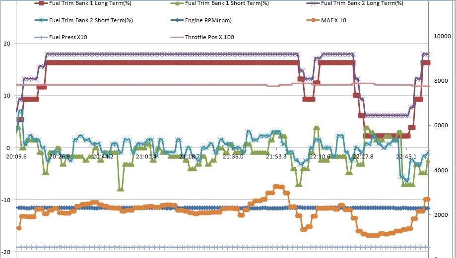

Those are so cluttered - a triumph of too many things crammed on each. I think they may show -ve trims so running rich at idle?
But +ve at 2300?
If so something other than an air leak, maybe bad MAF?
But +ve at 2300?
First of all, the throttle position line in the post #7 pics is bogus - I found an error this morning in that I was performing a calculation on the wrong column.
The 2300 data is taken from a section of the drive where cruise-control is active, 75 mph, and although predominantly level, there is the occasional rise and fall of terrain, as well as slight variation in temperature. The idle data is taken from being parked at work with the xmsn in P and the park brake set.
The replacement MAF I fitted last night seems to have calmed things down a bit. I did not clear the "Pending" P0174, and drove it to work this morning, then out to Autobahn Jaguar for parts and back at lunch; still no P0174, so still hasn't occurred on 2 consecutive OBD "trips."
Here is a snapshot of this morning's run: (sampling is taken at 1-second intervals)
Granted, busy charts, but there were questions about the MAF, and the fuel pressure....then I pulled in throttle position to see if it explained movements in the MAF data that looked otherwise unrelated to the other data.
Graham, Norri, Don, et al...I'm calling this one sorted by virtue of reverting to a previously-used MAF if you want to add "solved" to the title.
I replaced the MAF some time ago due to recurrent P0101 codes. I've since determined that was caused by a clogged intake air filter. Refit the previous MAF the other night, didn't clear the pending P0174 and it was gone after 3 or 4 trips and hasn't returned. Also, the data in post #9 is post-MAF change and reflects a much tamer picture.
