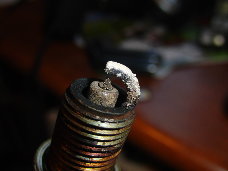

Well... after weeks and weeks and weeks of waiting I finally got in the coil pack(s) from back order. Even then, they didnt have a complete set, so I only ended up with one.
Since I only had one, I swapped out the coil pack and spark plug in the suspect cylinder, #4.
My understanding is the cylinder order (but not the firing order) is.

I swapped out #4, passenger side, closest to the firewall.
It was a very easy change, only took about 5 min. Attached in a photo of the plug that came out. I dont know much about plugs, but this one looks nasty... I belive it is the original plug. It was dry, there was no evidence of any kind moisture on any of the parts.
With the coil and plug swapped, I expected some change.... I got nothing. Its running EXACTLY the same. Maybe I swapped out the wrong cylinder? Its still super rough at idle, smooths out as I give it gas (unless I pound it, then I get restricted performance until I lift off the gas). Check engine light is still on. Still the same code. P0303 Cylinder 4 misfire.
I got the ELM reader off EBAY, but it was DOA, so I ordered a new (better one) from a local vendor. Once I have that I will capture the fuel trim data at 2500 and reset the codes.
Any other obvious stuff I should check?
thanks
Dave

You have the wrong layout of the cylinders
This has been covered so many times but hey one more......

It's in the Vehicle Specifications, well worth getting from here, and in JTIS - ditto.

hmmm... I guess I got the order wrong. I'd done some research via the forum and found this link:
Automotive Forums .com Car Chat - View Single Post - Misfiring?
this is what I thought was correct.... I'll check it again and see if there is any difference
thanks!
Dave
