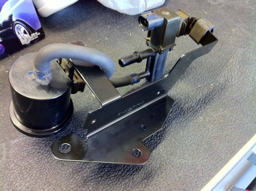

UPDATE: The issue has been solved, I no longer have P0456 "very small evaporative emissions leak".
Firstly, I have to give major thanks to a local jaguarforums.com member mafioso for meeting up with me during a holiday week and helping me diagnose the problem with my car. I spent HUNDREDS of dollars with a local shop and they could not find the leak.. but mafioso was on the right track within minutes of opening my hood. Thank you Luigi.
Alrighty.. here is the issue.. I had a small crack in my Evaporative Emissions canister purge valve resonator.
The canister is poorly constructed and the edges seem to be easily cracked. Even my new canister looks a little shady on the edges. See the picture:
Jaguar does not sell this part by itself, but they do sell it with the evap purge valve along with a metal bracket. The Jag part # is XR830786. It cost me $99 at my local dealer.
This is basically what you receive (the pic is of my old broken one)
To remove and re-install this part is VERY easy. I can't believe the shop wanted to charge me several hours for this.
You simply un-clip the wire to the valve actuator, remove one hard-pipe vac line by pinching the release clips and pulling, and remove another vac line. Then,pull the unit off of the rubber bushings that suspend it in the air.. be careful to detach the last vac line which is a hard plastic clip pipe that is under the resonator. You're done.. now stick in the new one. (reverse the steps)
The 'kit' comes with a new metal mounting bracket.. but tha requires you to remove the bolts that hold your strut in place.. and I just didn't want to jack with that and have to re torque those down.. so I just removed the components and placed them onto my existing bracket. I used the new rubber bushings, though.
After the swap is done, reset your CEL.. go driving and make sure the light doesn't come back on. You can only "test" the evap system when there is between 1/4 and 3/4 of fuel on board.
I went to a flat piece of road.. accelerated briskly to 50 MPH.. held it for 2 min or so.. then let off the gas and let the car coast to a stop. I would idle for 4 minutes. After nearly 1 tank of gas and no CEL.. I knew it was fixed. I also went and got my car inspected today and the evap emissions test showed the car had done it's self check and it was PASS.
