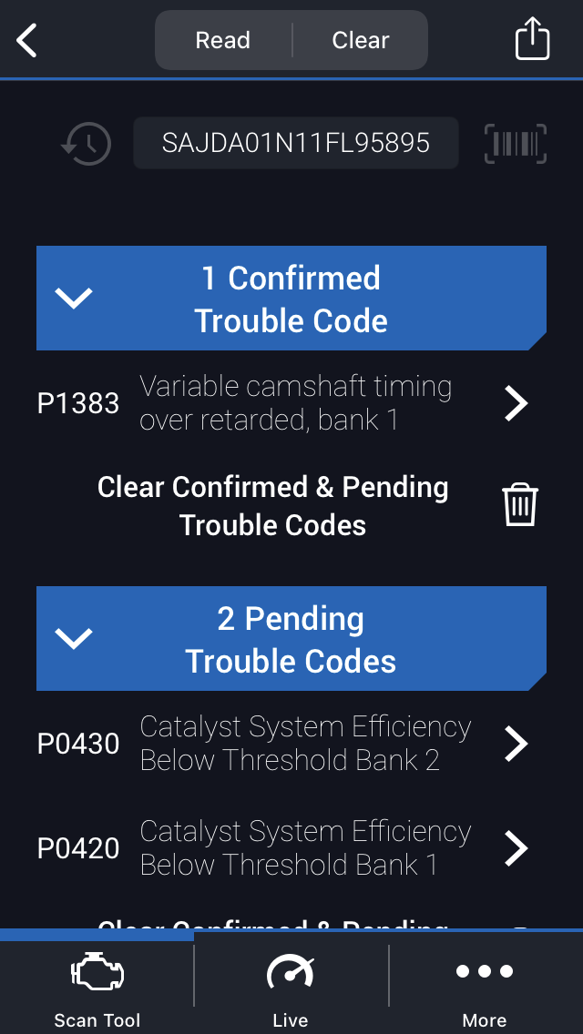

Went for a long ride today , and sometimes the MAF reading fluctuates from 1.7ish on idle ( meaning the trim is also -20s or +20s when driving , and noticeably burning too much fuel ) to 0.3ish ( when the trim is USUALLY nicely zeroed in )
And here’s what comes up on the scanner 📶

Reads like a massive air leak and/or 2 bad O2 sensors.

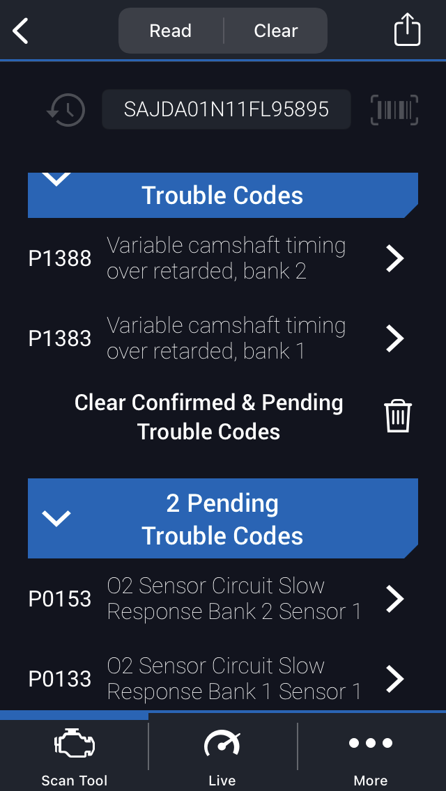

So I’ve been driving up steep hills on full throttle lately to help clear up the VVTs (ands already been around 700 miles with that quart of ATF)
And those trims still fluctuate from -20s to +20s

Oh and certain vacuum leaks will throw a p0430 “catalytic inefficiency” code under certain conditions. In fact ive never had a bad cat but ive seen many p0430 codes after fixing the majority of vacuum leaks in my STR. So whenever I see p0430 I think vacuum leak.
I need to see a running graph of the voltage (for
downstream o2) and current outputs from the upstream O2 sensors over a few minutes. I bet the first o2 sensors showing low (negative) currents and the second 02 sensors (voltage) are biased high.

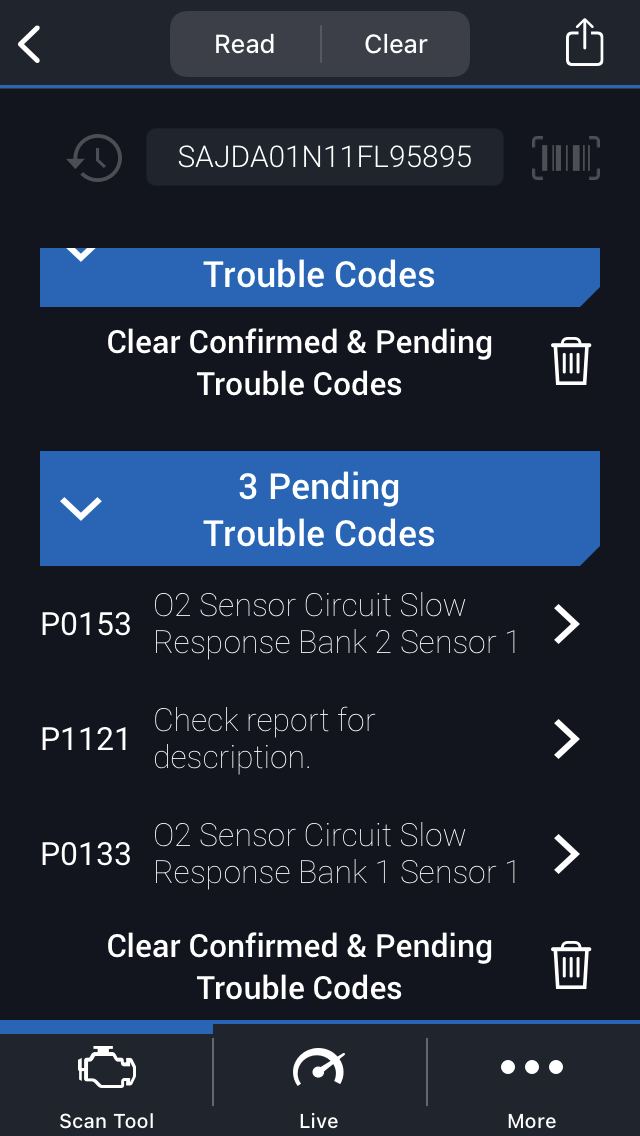

Well, at some point, you're just going to have to try something and see what happens. We don't need any more videos of fuel trims. Unless someone else can chime in to interpret them, I've no idea what to do with them. Maybe post some cat videos instead. They will provide a similar level of information but at least be more amusing.
Yeah, I'm busting your butt. Not sure any of us can come up with some magical 100% guaranteed solution based on all the clues so far. Remember, you've reached the stage of stupid and futile gestures. It's time to just try something and see what happens.
Resist the urge to try several things at once. Don't change a whole bunch of sensors at the same time. Make your best guess and try that one thing. Drive for a few days and watch the symptoms. This is to prevent the dreaded situation where symptoms get worse, but you don't know which of the 6 parts you just changed had caused it.
Where to start? Are you absolutely, positively sure all intake air leaks have been repaired? If so, I still think the P1121 code is your primary concern. That's the computer's way of saying the TPS and MAF values don't agree with each other. Which is more likely to be wrong? The TPS has two independent channels that are constantly compared to each other. You'll get a different fault code if the channels don't match. It's extremely unlikely that both channels would fail in such a way as to still agree with each other yet put out a combined erroneous signal. Not totally impossible, but I think it's more likely that Nancy Pelosi would get a tattoo of Trump's name inside a heart.
So working on probability alone, I'd suggest an MAF sensor first. JagV8 was thinking you might have a pair of bad O2 sensors instead. His guess is as good as mine. Pick your poison. Anybody else brave/foolish enough to chime in? Anyone? Anyone? Whatever you do, STAY AWAY from no-name bargain parts, such as offered on eBay. Same goes for the store brand at discount chains. This stuff is almost always Chinese junk that will cause nothing but grief. Stick with quality name brands such as Denso, Delphi, Bosch, etc. There's a reason they cost more. Don't skimp out here.

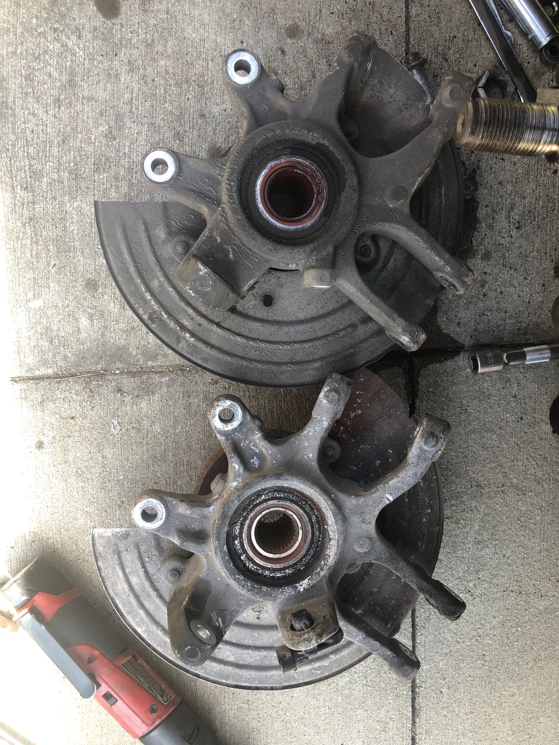

Question … So I’ve changed that hub lately , and this ‘03’ part has a different kind of sensor ( detachable ) than my (wired ) ‘01’ …
Thus ABS 🚨 is flashing due to this dislocated sensor …
Does this have anything to do with that MAF & TPS synchronicity ?

Yeah , when the live data screen is on , shutting the engine and then turning the key , keeps that screen on , and the coolant temp and MAF Sensor gauges reading 📶 (and sometimes the MAF Sensor reading shows from 1 to 3 , and either zeros out or is stuck on something above zero , so I usually wait till it’s below 1 to start the engine for fuel efficiency ) 🤔
Drove it a few hundred miles today and the MAF reading looks aligned with the trims ( thou occasionally it’s easy to notice the VVTs getting clogged and then unclogged ‘)
O2s , P1383s, p1121 , and cats are 🚨
So will it be alright reinstalling the O2s while the cats are dirty ?
