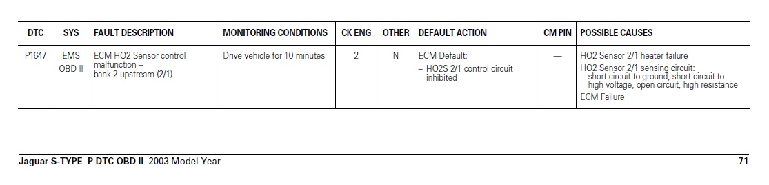

The Jaguar DTC lookup for P1647 indicates it's not going to go away without some remedial action:
I'll leave your question here in General Tech Help and see if it gets advice from members with the same model. If not, I'll move it to S-Type forum.
