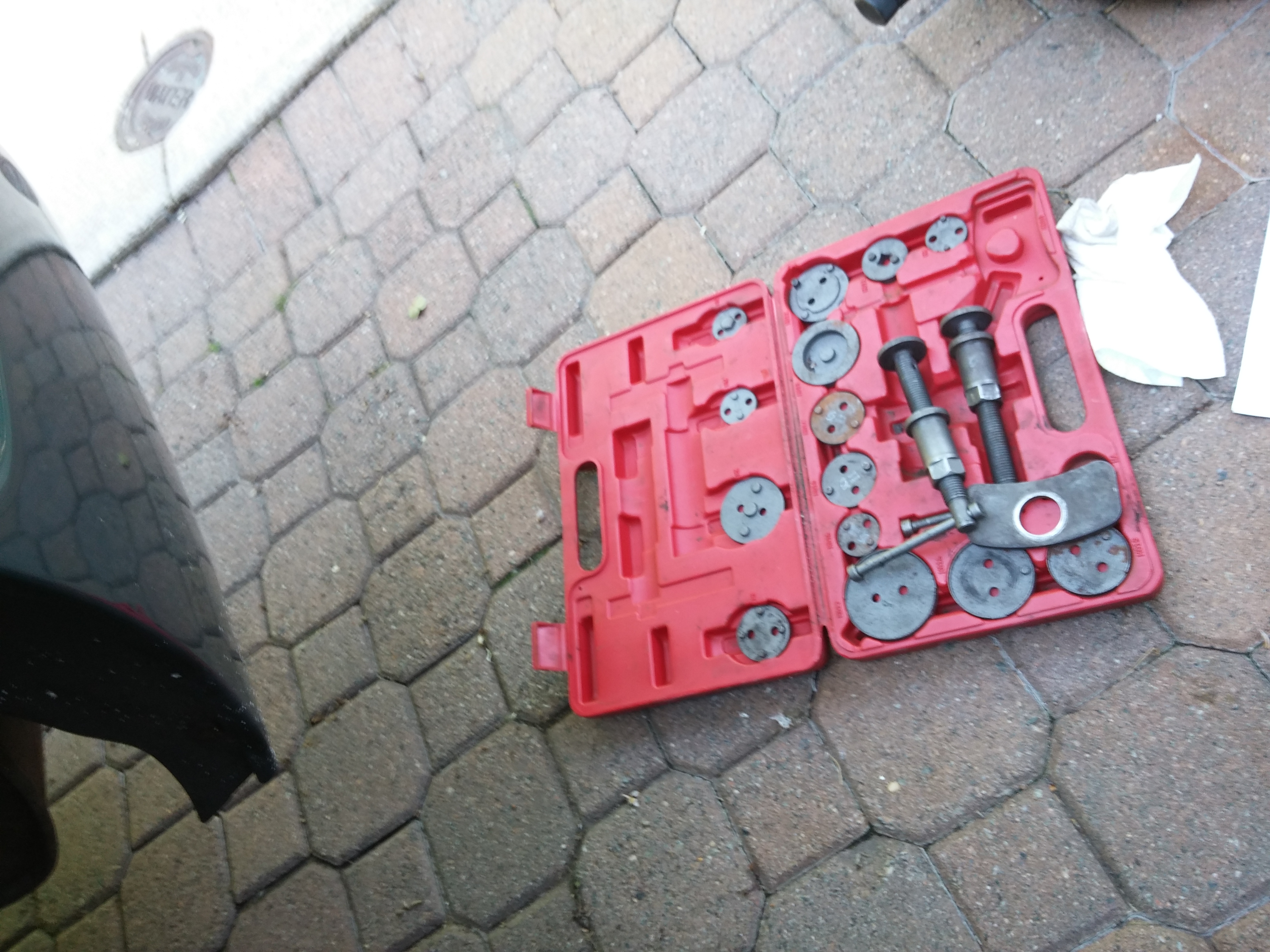

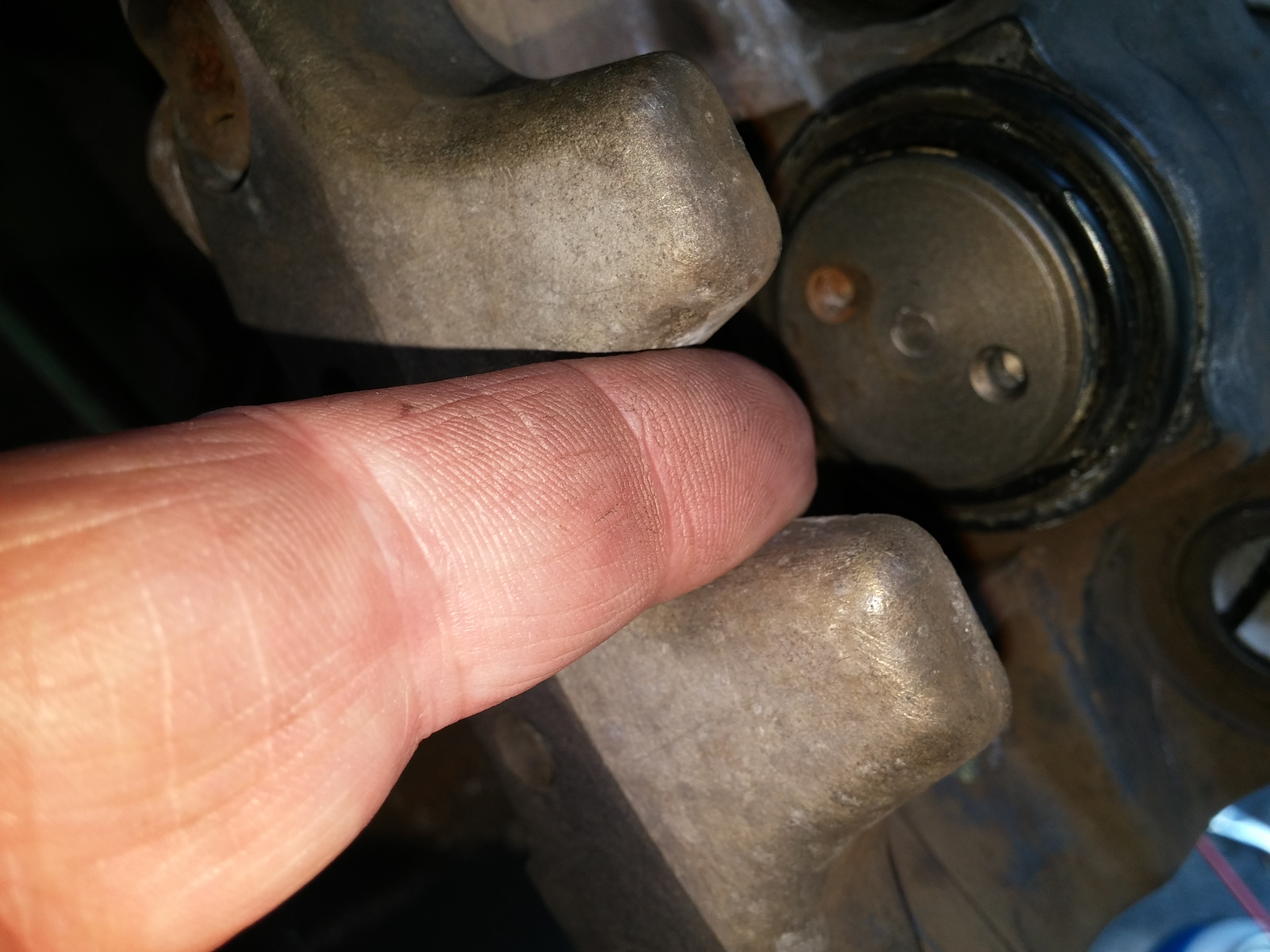

So I've looked at plenty of posts and threads all over the internet but what I can't find is a specification for which tool fits in those two pin holes. They are tapered at the top and then get straight with an approximate diameter of 3 - 3.5 mm.
I've tried the Autozone kit and no good. That's just the problem as all of the kits don't seem to have any way to figure out if it has the tip I need.
What am I missing.?

Perhaps this:
https://www.ebay.com/itm/21-pcs-Univ...-/191554748016

That looks a lot like the kit I got from Autozone, it worked for me but the Brembos may be different.

the kit nbcat links to ebay is the same one I purchased ...it has the one that the autozone kit does not have and a couple more...it worked perfect for me...I went down the autozone path also first with no luck

You can get this as a free loaner tool from Autozone or Oreilly. Just call first and ask if the brake piston kit is in.

This car has the Brembo calipers and yes ... a separate mechanical emergency brake. It's not electric itself but the calipers are pulled on and released electrically.
Neither the Autozone or Advance Auto had kits with adapters that fit and I was about to flag down one of those Tool trucks but decided to stop my mechanics shop. He works on my Suburban. I didn't ask to borrow the tool just see if he an adapter that fits so I could figure out what to order. He said here take it but bring it back soon. I ended up giving him $20.
His kit is made by Sunnex and the adapter that works is Sunnex #393013 which you can look up.
The pins are 4mm in diameter and centered 20mm apart.

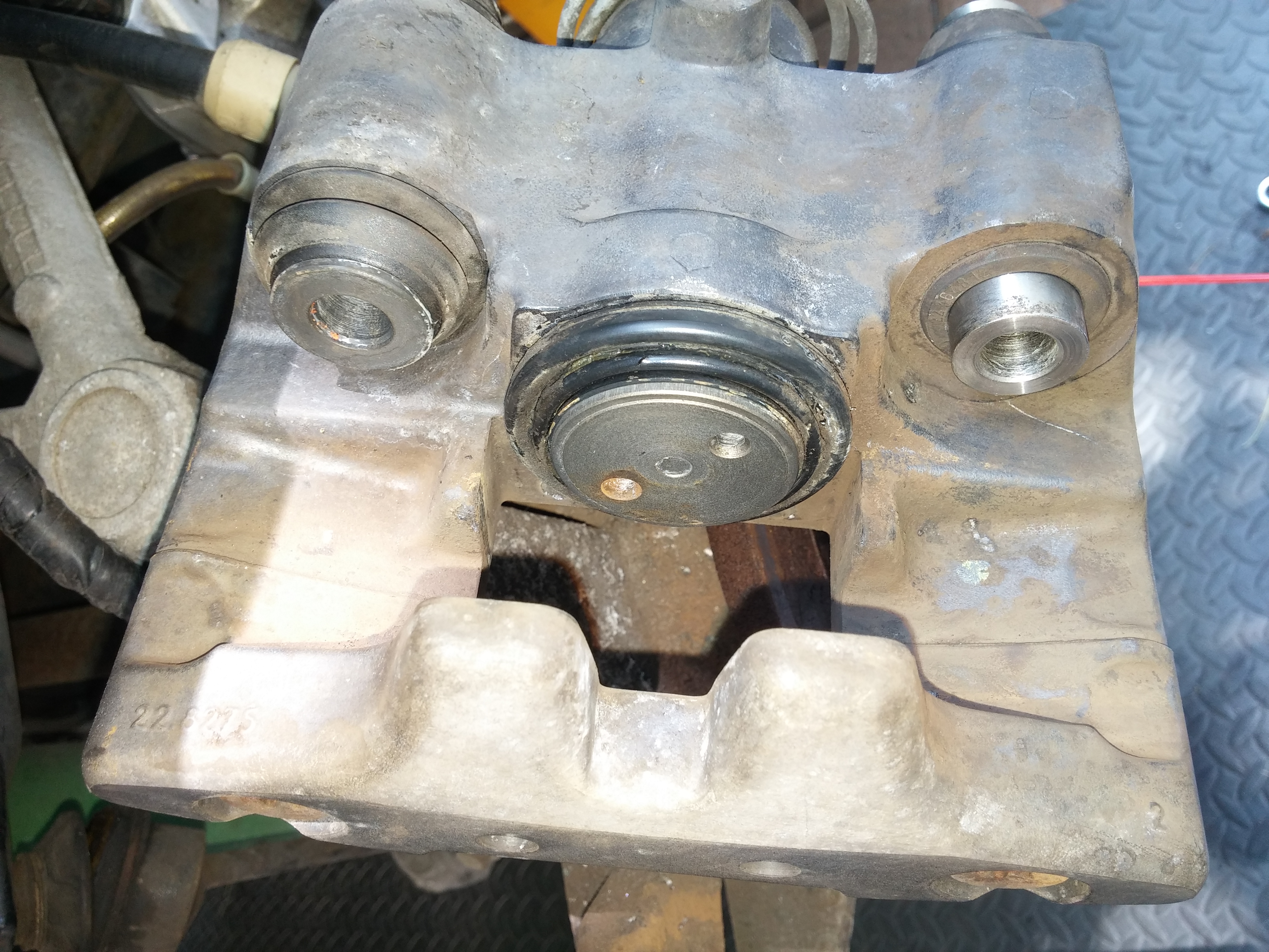

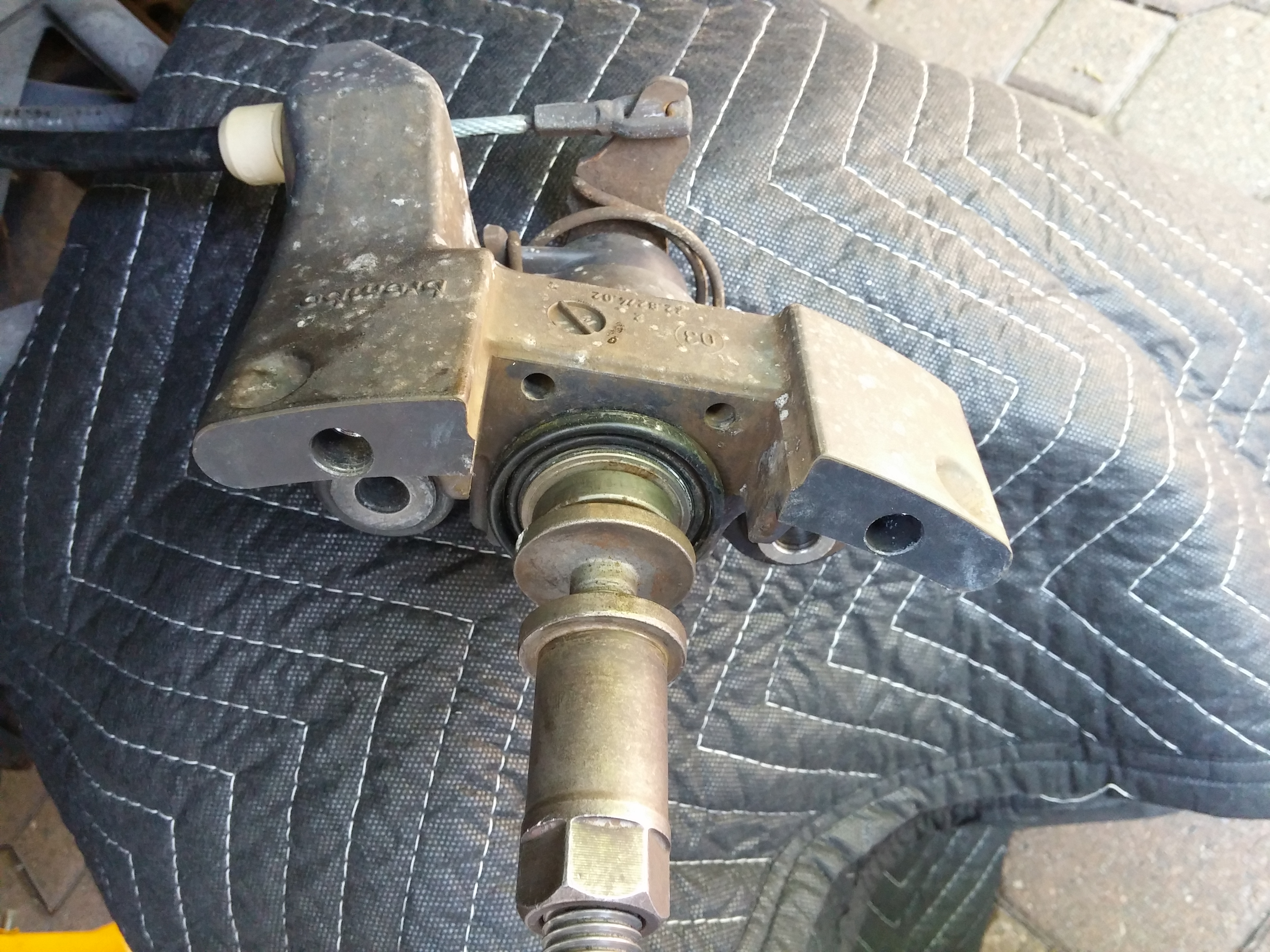

The fun continues though. You can't use this kit or any other really in the standard way because the shaft won't fit inside the opening. So you have to split the calipers by removing the two torx bolts and this best done with the caliper still bolted in to rear upright.
Once you have the caliper removed from the mount you can just take the big screw drive T handle from the kit and adapter to adjust it all the way back. While turning it's easy to see if you're opening or closing the gap. I beleive the two sides operate differently.

Good job and great pictures too!
