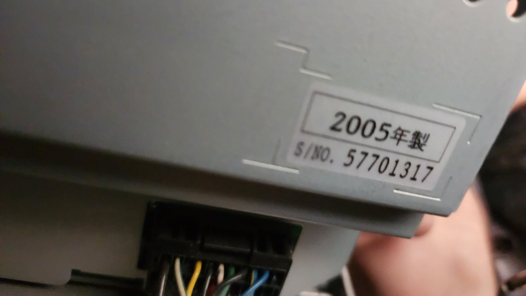

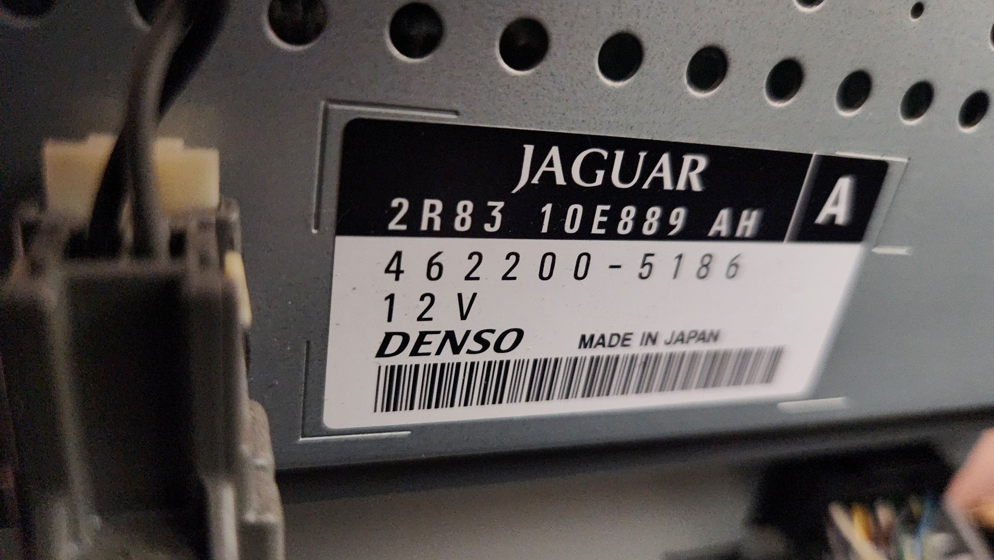

I check the back of my current display, and here are the pics:
My cars display manufacturing year.
My car's display manufacturing year.
My cars display info.
My car's display info.

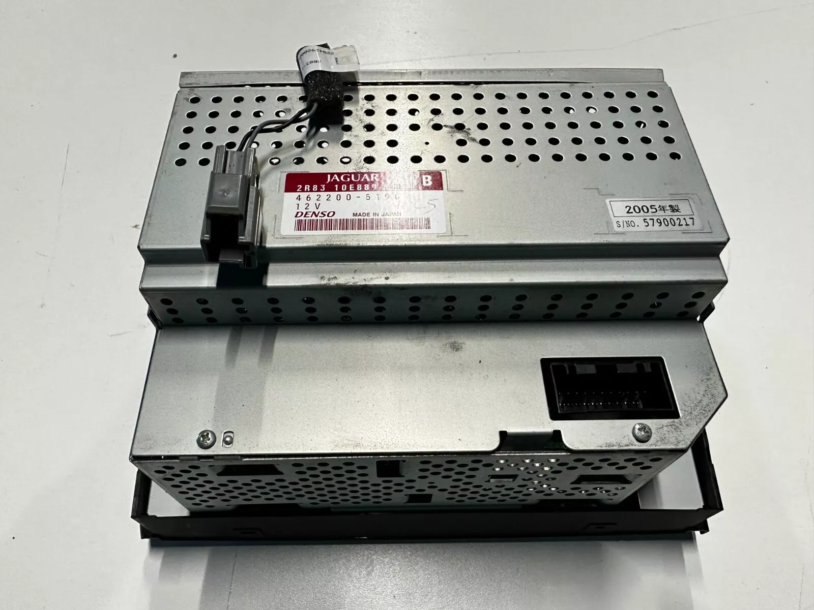

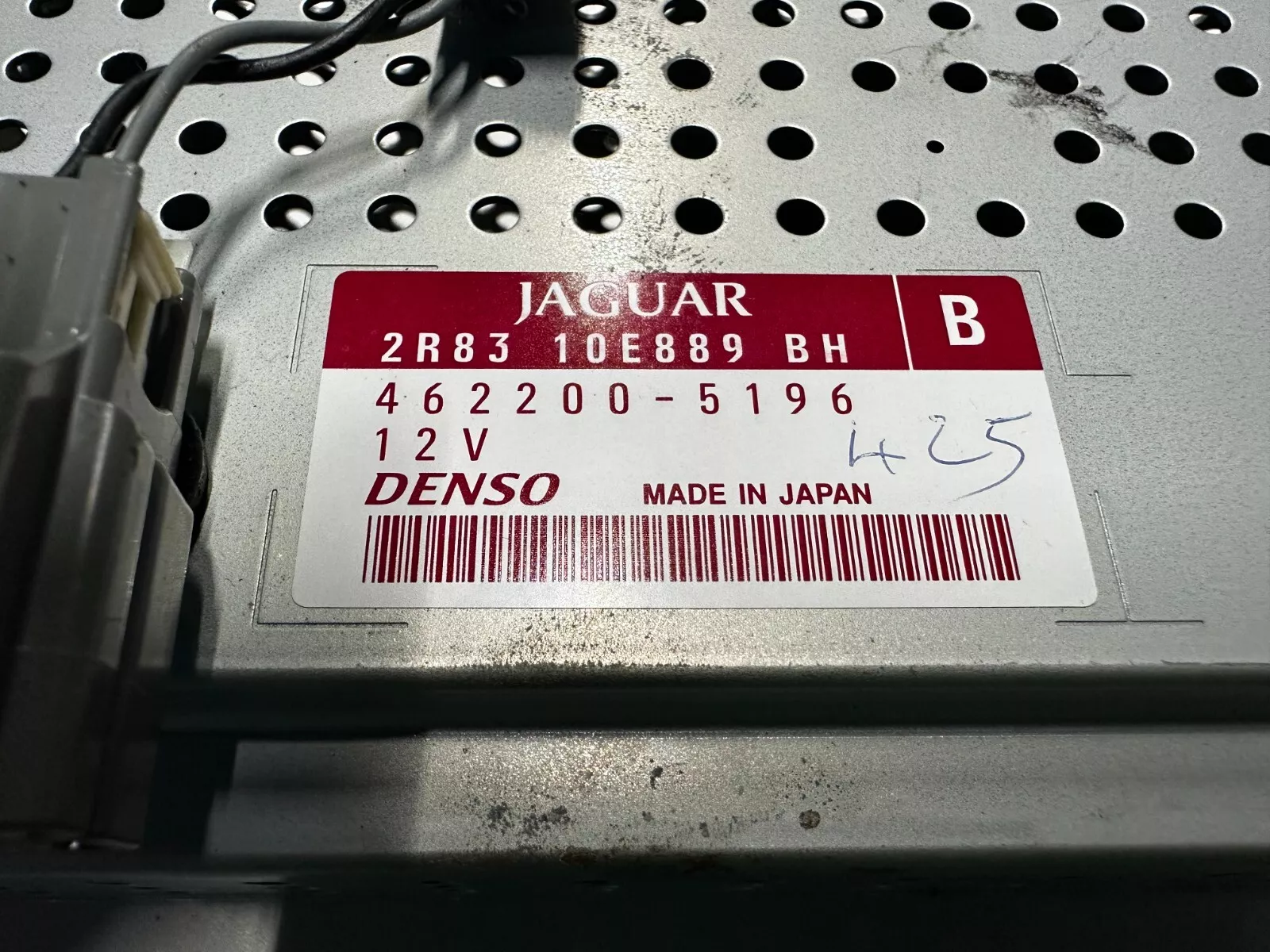

I found this potential replacement online, and I was wondering if it would work for my car, even though some of the numbers are different?
Thanks for the help!

Doesn't look like a/c. More like the screen?

Thats the touch screen
the climate module is a black plastic box, its above the glove box
if your climates playing up its either the module above the glovebox or the DCCV or both, as a bad DCCV will pop tracks inside the climate module

Last two letters are just version numbers changed when there are slight modifications/updates to the modules. It will probably work okay.
