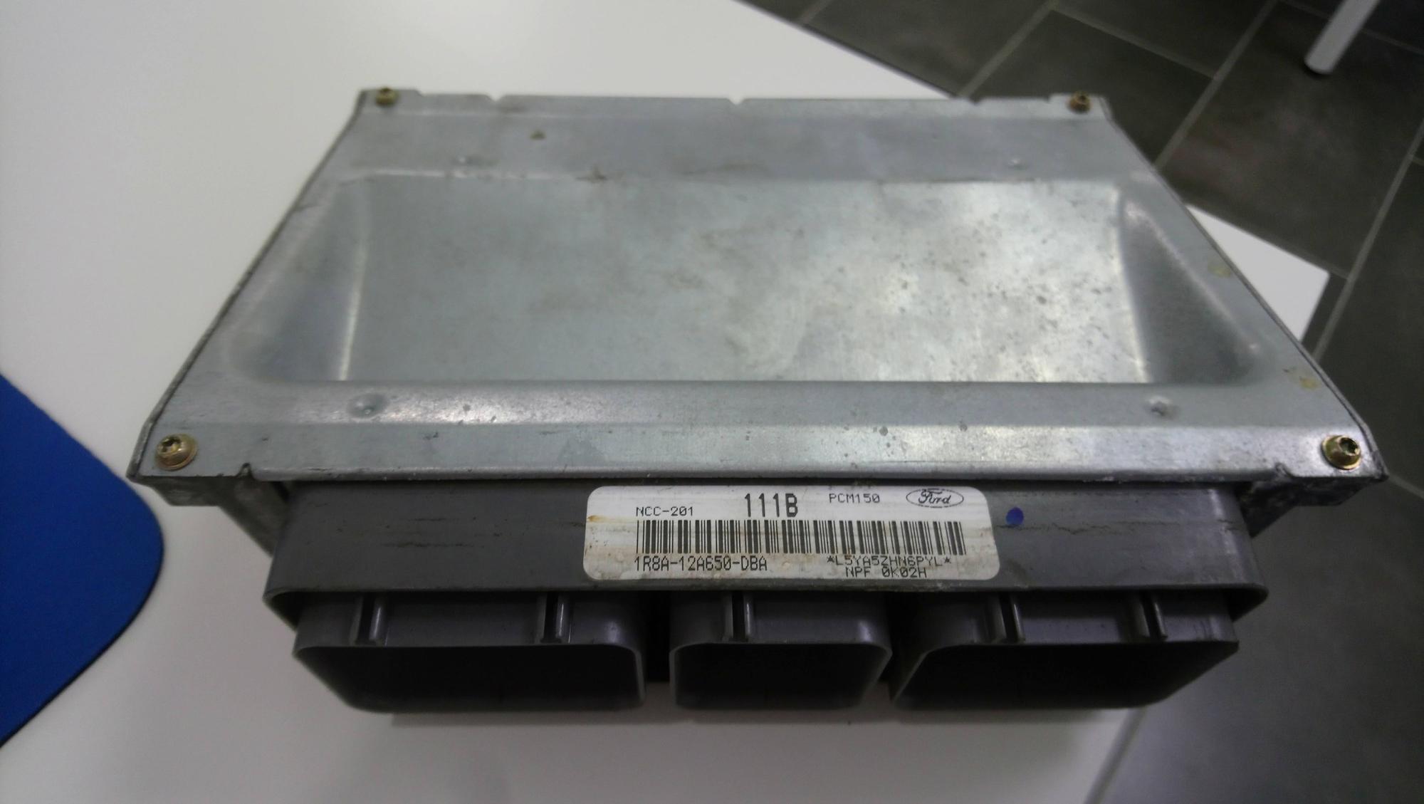

Update, i think i metioned before that the car is no longer with the PAT code 22, after that there was a problem with lost communication with the computer, the mechanic couldn't connect to the computer. so, he was traising to se if it was ground it somewhere, en up searching everithing and was ok but he couldn't find the FC35 junction, at the end find it and also OK.
Other guy came, this one works with Jaguar cars (first one works with ford cars and had some experience with Jaguar), so, the problem now is that the Computer is not working, this is a picture of it and the codes that it has.
I have found several with the code 1R8A-12A650-DBA, but it says that is for a 2002-03 car, mine is 2001.
am i looking at the right code part?
For example, this one on ebay
https://www.ebay.com/itm/22443547624...0AAOSwB1VggcsJ
has:
NCC-201 111B PCM150
1R8A-12A650-DBA
Matching the one on my car (also the car in those ebay pictures match the color of my car too ), but again it says 2002-03.
Those this par fits my car?
Am i looking at the right numbers?

My understanding is that you cannot reprogram those to a different car, so you probably cannot use a used one (new ones are blank, known as "green", and can be programmed once in the way needed).
Clearly the above could be bypassed somehow but there is no market to do that.
Keep your existing PCM and fix whatever is wrong.

Yes PCM failure is very rare and I would send the PCM to a repair place and see if they can find a problem with it? I am not convinced that is the problem. Can you post what codes the car currently has? Fixing the PATS 22 code should be a step forward? Or does he mean his scanner can't connect to the car? Could be a wiring problem affecting the OBDII port? The car now has been disassembled a good bit which in and of itself can cause even more problems.
I have done this exact thing with my old 2005 S Type after an accident. Problem is there is a wide range of people promising these repairs and most of them don't really know what their doing. I had my PCM broken in shipping which is another hazard to consider when sending parts like these out in the mail. In the end my problem turned out to be a blown fuse which is still embarrassing to me as I thought I had checked ALL the fuses previously!
Good luck and keep posting. You will find it!

Yes PCM failure is very rare...
my problem turned out to be a blown fuse...
Yeah, I highly doubt the PCM is bad. I'd be willing to bet your reputation that the PCM is not receiving power. A quick check of the wiring diagrams shows at least three fuses and a relay on the supply side. A failure of any of those would make it appear the PCM is dead and not communicating. I'd highly suggest checking for power to the module, as seen in figure 03.3 here:
http://www.jagrepair.com/images/Auto...x2022001en.pdf
At the PCM connector FH1, turn the key to run and check for battery voltage at contacts 32 and 33.
See this Jaguar training guide, pages 1-8 through 1-10:
http://www.jagrepair.com/images/Trai...es/870B_SG.pdf
Once a PCM is configured to one vehicle, it cannot be installed on another vehicle. On the exceedingly slim chance a PCM had to be replaced, you would need to install a brand new unit, not a used unit from another vehicle.
I'm not sure if this applies to later models, but that is what Jaguar said for the early models.

Are you guys sure about that?
Yesterday before posting i was searching youtube to see if there's a way to repair Ford or Jaguar PCM and found this videos
I'm not saying that you are wrong, belive me, i don't know anything of this. i will go right now to the workshop to be sure if the PCM is getting power. i thought the same, that it's hard to believe that a PCM is damged.
Probably it can be done and Ford did not want people to buy used PCM and buy new ones from them, Or problably it's true that it can't be exchange .
I'll will check if it's getting power and let you guys know what i found.
Thanks!!!

Just be careful as while Ford and Jaguar were combined in the past they are not now. A dead common GM or Ford product yes you can do this and whole lot more. These systems have long since been broken down and hacked. You can program almost anything and everything with the right software. Jaguar is a very tiny slice of the market and we don't have hundreds or thousands of guys modifying and tuning these cars.
Is it possible? Yes of course if you put enough time and money into it. I have actually un-sodered individual chips and moved them to a new module so the car does not know anything was changed. But how do you find what chip does what? Lots of trial and error or some insider to the company giving you the keys to the kingdom. It's just software and it ALWAYS has a back door somewhere! But can YOU find it??
It's my understanding it does NOT apply to later models (which use a Denso PCM).

you can’t do that trick with jaguar ids
if you have a ptec car you are screwed, they are the only ones that need a virgin pcm. buy a pcm cluster keys and ignition from a donor.
with later s-types a used pcm swap is no problem

Where to start? That guy may know Ford trucks/cars with overheat problems but your Jaguar hasn't got any sign of such and they're vanishingly rare (try Search and see).
You won't be able to run the sequence he shows. It's also not appropriate.
You would be far wiser to figure out the reason for the PATS code you have & fix it.
Bear in mind that if you attach a used PCM your car will go into anti-theft so have a plan for what to do next. It won't be easy.

cluster pcm keys ignition are all you need to swap a ptec car
if it’s not water damaged his pcm is probably good regardless
