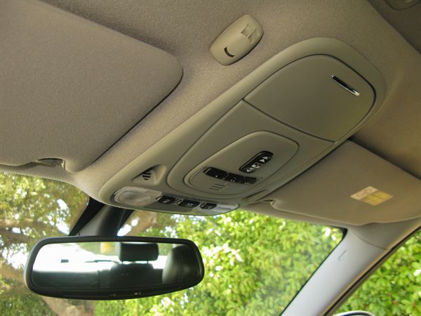

The early cars used a mic in the overhead console. Many complaints about poor sound quality. Then the external mic came out and it plugs into the overhead console. Here is a picture of the external mic if you have one.

Definitely no separate mic visible in the headliner, but there's a grille in the roof console so that is probably the mic.

First things First.. All those little buttons are sensors for other things, like climate control. Not microphones....
Second of all... All Jaguar head units (stereos) in 2005 have built in CONTROLS for the phone...Nothing more. The phone had to be added as an extra module. They just built one stereo since that would lessen the complication of adding the phone later. (Also a convenient way to up sell customers on the phone as well when they ask "What does that phone button do?"
The easiest way to check for the phone is to look for the microphone pictured below in post #13 from Tbird6. Also, if you unscrew and pull the console box, there should be a phone module mounted there. (That is where it goes when it is added). If no module, then no phone. If you wish to add it, it is pretty easy but real expensive.. I have yet to find one on the cheap... Less $$$ to pull the head unit and replace it with one that has built in bluetooth.
