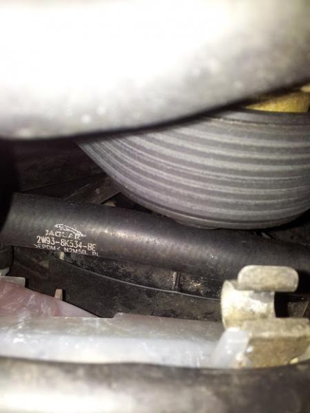

Ok lucky me I developed a pinhole leak in a hose that is going from the dccv to the thermo housing.
Below is the only part number I see on it
Attached Thumbnails Pinhole leak in coolant hose need help finding hose-img_20130130_171859.jpg

I have had two identical sized leaks on my 2005 STR. Too small to find until everything cooled off. Used a coolant pressure tester and a small mirror to see down in and under the mass of hoses. I ended up replacing every hose I could. Even if they looked OK. Inter-cooler, all DCCV hoses, upper and lower radiator hoses.
It's was a pile of hoses when I was done!

DCCV Coolant Return Hose.
