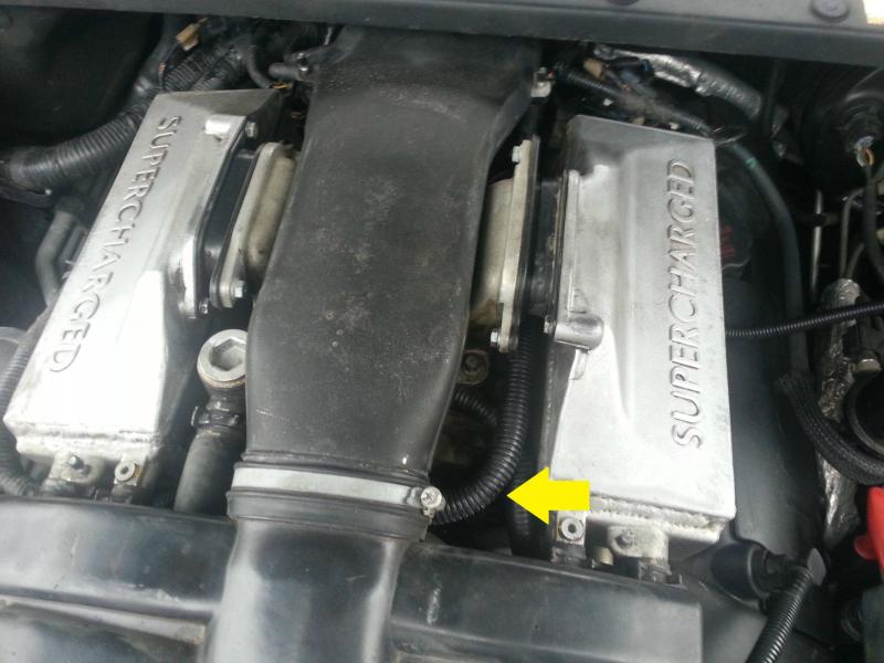

This is where the leak is. Well thats what I assume since as soon as the mechanic moved it, the sound quieted down about 75%.
Attached Thumbnails Question about high flow cats-hsvqien.jpg   Question about high flow cats-p0u7cmh.jpg

Sorry that it posted that twice. I will get it fixed properly, I just need something to hold me over for the rest of the week.

Joe, that's the crankcase ventilation hose running from intake manifold on drivers side to the front of motor, inserting on the PCV valve on passenger side cam cover. It's the largest vaccume line. It may be cracked or the intake manifold gasket is leaking. If there's an intake manifold gasket leak, moving the hose over the intake will give the impression that the hissing subsided as it covers the area of intake manifold gasket leak. Remove the hose and test it for leaks. On the STR, the charge coolers are in the way of properly using spraying ether to test for intake manifold leaks. A smoke machine will do best to detect most leaks. You mentioned that this car was fresh back from a blown head gasket. I'm betting the douche bag mechanic messed up vaccume lines upon reassembly, or worse...improper sealing of the intake manifold, etc?

If that tube is leaking it will give you rough running and lean engine. That produces the same crankcase leak as leaving the oil fill cap off. Try that on a good running engine and watch how crappy the idle gets. Not only does the intake have to be tight for proper air to fuel ratios, but so does the crankcase. Dipsticks orings go bad and are big leakers too. Yeah tape is fine till you get the new tube
