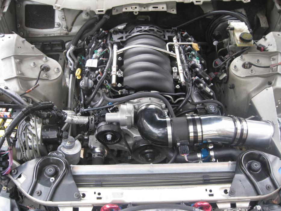

Here is an image of the engine compartment.
It looks like it should run (LOL)
Wow. Good luck - I hope it DOES run!
