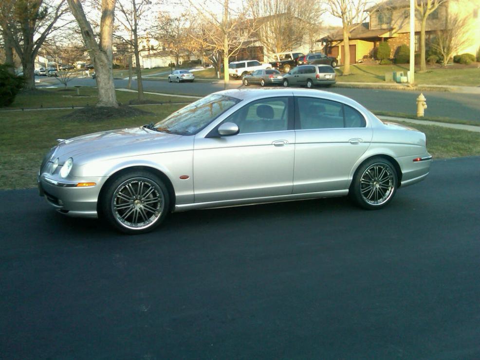

I have 9" all around I believe. The sidewall is on a bit of an angle almost like the 245 is a bit stretched to get on there. If it will work, I'd MUCH rather have the extra 1/2" of sidewall. The speedo difference is negligible enough.
I potentially MAY have a bent rim - although I'm hoping my 45-55 mph wheel shimmy is a balance issue.
And I don't have an STR (although I wish if anyone wants to donate to the fund). I have an 03 3.0 on stock suspension. = Which has more wheel gap than a monster truck lol.
I've attached a pic of what the car currently looks like.

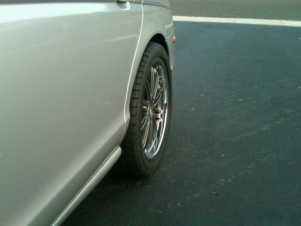

I got the tires mounted and road forced balanced on my car. They fit, and do not rub, but look sort of out of place on the car. There is a pronounced difference in the amount of sidewall... But it almost looks like something that belongs on a muscle car rather than a luxury car, especially with the 275's in the rear. It's amazing how much smaller it makes the wheels look too...
However I can't complain for $150 (mounted and road forced as well), from a friend, but I'm not too thrilled with it. I'll attach some pics so you guys can get the idea.
