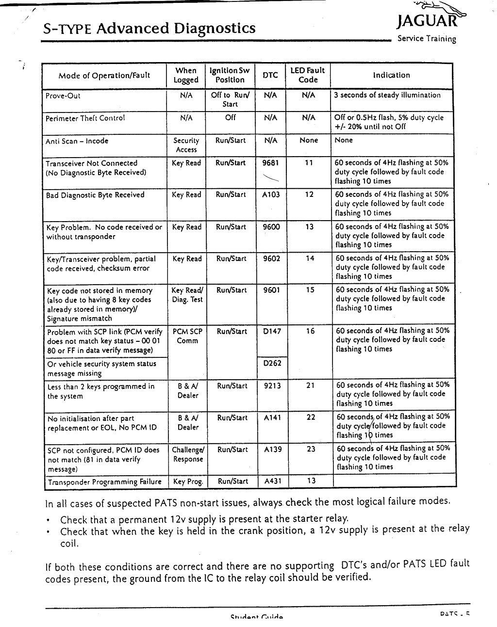

My 2002 S type won't start -- the security immobilizer is activated -- how do I reset it

Needs a dealer tool.
What happened?

Look at the PATS light and count the flashes??????
Here is a pic of a page from my Student Guide.
