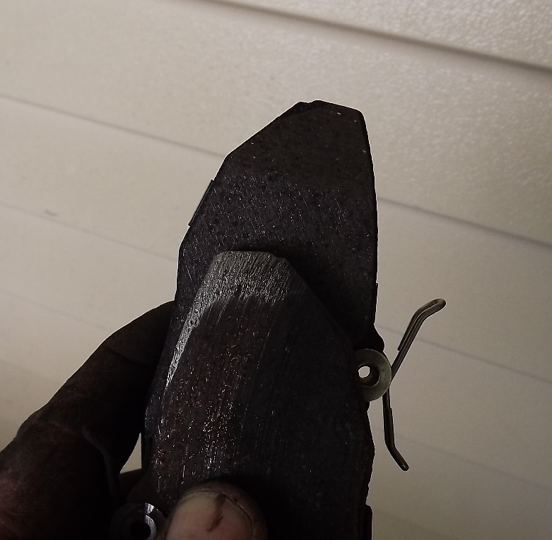

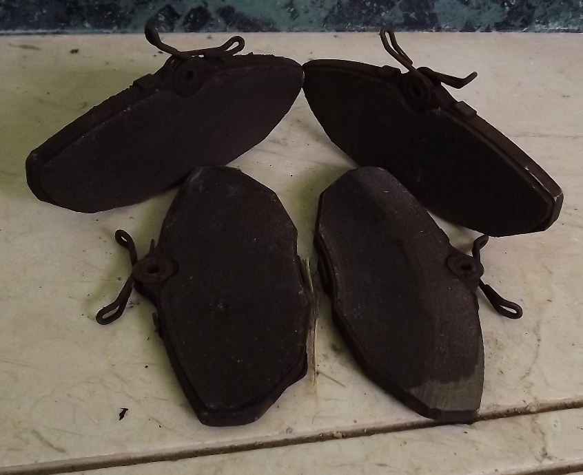

Expecting that the rear brake pads would need replacing, I decided to get a new set - and I'm glad I did. On removing the wheels and calipers I found that the rear pads were worn down to just a sliver of friction material and one had even worn so far as to be making metal-to-metal contact (thankfully with no significant damage to the disc). The previous owner (an aircraft engineer from Abu Dhabi) claimed to have maintained the car meticulously. Given that I've only done 7000km in this car, that level of pad wear indicate a long story of neglect, so the moral of the story is never trust the previous owner! Pictures below:
All four pads:
Slightly worn
Yellow arrow for new, red for old!

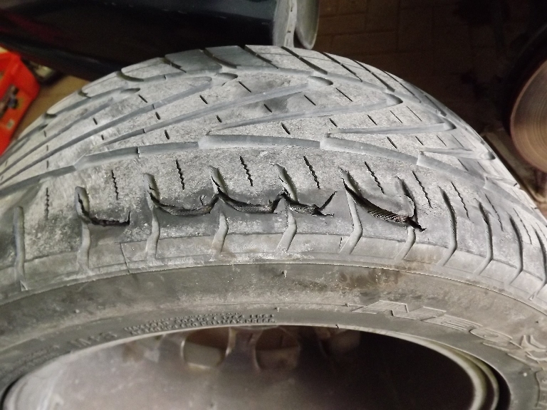

As a costly bonus (?) I found this tyre damage - split and showing the steel cords - and I'd been driving at high speeds on the main roads! This was the inner edge and was not clearly visible when the wheel was on the car. The front tyres were also a bit worn (because the steering alignment was a bit out) so with 3 out of 4 due for replacement, I bit the bullet and replaced all 4. Still, shouldn't need doing again for a while.

Hi Richard, Glad you caught that tire defect. They usually make a flopping sound that can also be felt when that happens.
I'm not sure you can infer anything about the PO's maintenance practices nor his/her honesty from the condition of your rear brake pads. Clearly, it was time to renew them, but that is a wear item and as long as they are changed before you hit the rivets, no harm done - that's just utilizing your wear items (and maint. $$) to their full extent. Remember, he/she was selling the car roughly 4500 miles ago - not many people replace brake pads when contemplating a sale unless they are truly gone and it is necessary. If still serviceable, you leave that for the buyer....now if he/she marketed the car as "new brakes all 'round" that's a whole different matter. Take a look at your front pads, they wear quicker than the rears b/c they shoulder most of the braking load. If your inference is correct as to his/her maintenance practices, you will have a real problem up front given that your rears were nearly gone.
