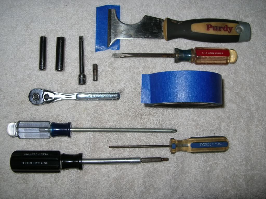

Tools needed: T30 and T15 Torx drivers, regular & phillips screw driver, ratchet with 8mm and 10mm sockets, (extention optional), trim panel removal tool (I use a painters 6 in 1), masking tape, flashlite. Better have some Band Aids close by (optional but needed) .

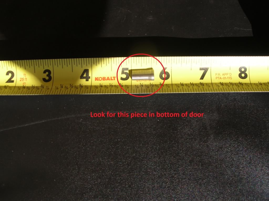

Now look for this piece somewhere in the bottom of the door. If you cannot find it, time to purchase a new actuator locking mechanism. STOP NOW!!
Attachment 167711

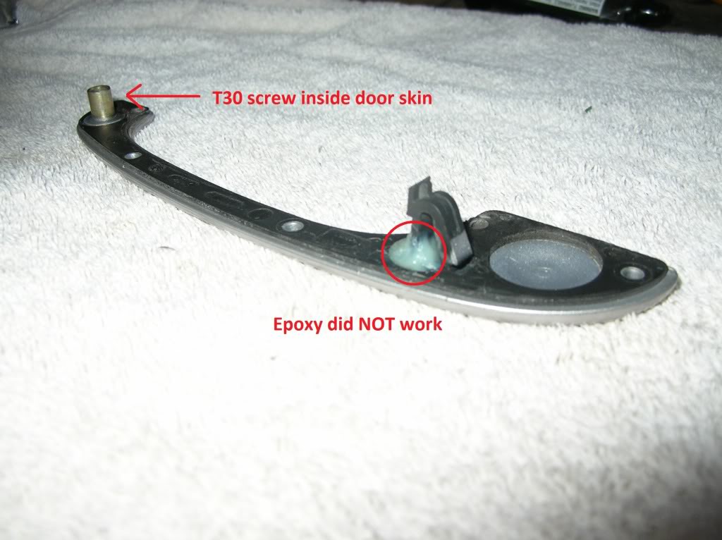

Time to remove exterior door handle trim. There is a tab that MUST be pushed forward to unlock the trim from the door! I BROKE THIS TAB. In the following pictures I tried to expoxy tab back on but it did not work. I ended up using 3M tape to resecure trim piece, remember there is a front T30 secrew that holds it firmly in place.
Attachment 167715
Attachment 167716
Attachment 167717
