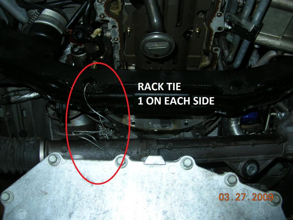

for any who have done this procedure: can I just unbolt the (looks like three) bolts holding the steering rack to the crossmember and swing it out of the way? And then reassemble in reverse, without any issues?
On a 3.0 you can, but instead of swinging it out of the way use tie wire to hold it when lowered out of the way.

Cool pic! The STR may be more.... hmm... challenging.

True, but not so much for dropping the rack, I believe.
