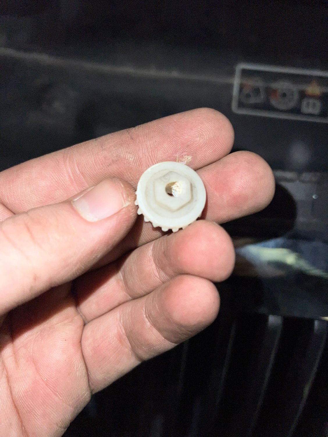

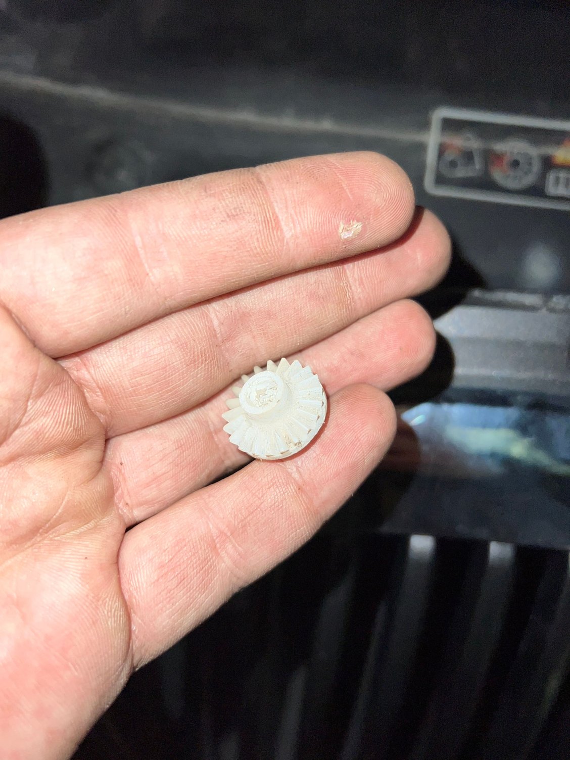

The funny plastic piece I have no clue about

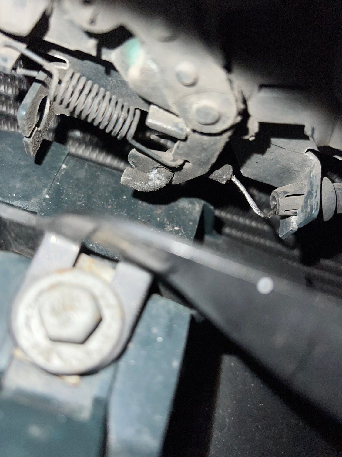

Hi there, I’m gonna be short and sweet: had some issues with my 2001 s type like tie rod end dead, coolant tank leaking at the tube, full rear suspension rubber rot. Fixed mostly everything, used grease needle to grease up the lower ball joint, water started escaping from a tiny pin hole on it under pressure, will seal with black silicone tomorrow. And as always, some funny business: hood latch got stuck on passenger’s side. I new this may happen, this check the cable before, it was great condition, still broke. Ended up removing most of the plastic from the underneath just to catch the cable with wire through the grill lol. Don’t have the cable on me, so just removed the passenger hood latch. Question: is it ok to drive with only driver’s hood latch+hood catch? And while working under the car I saw a little plastic piece on the ground, not sure it’s from the car, if it is, what is it? Pics attached. Also, here is some more info/question from previous post on general:

That white thing looks like one of the adjuster "cogs" "for the headlamp adjustment.
It would be normally be at the back of the headlamp directly below the white adjustment "nut"

Some questions you ask are hard to answer but I can tell you that the little cogged plastic wheel is from the headlight adjustment system that sits at the rear of the light housing. You should have one visible on the other side to see where it goes.
I’ll let others chime in to try answer your other more challenging questions. Good luck eh!

Replace the bonnet release cables together, which requires removal of the cooling system expansion tank to allow the primary cable to be routed through the body. It's not a good idea to drive with one of the bonnet latches removed as the bonnet is aluminium and can become distorted.
