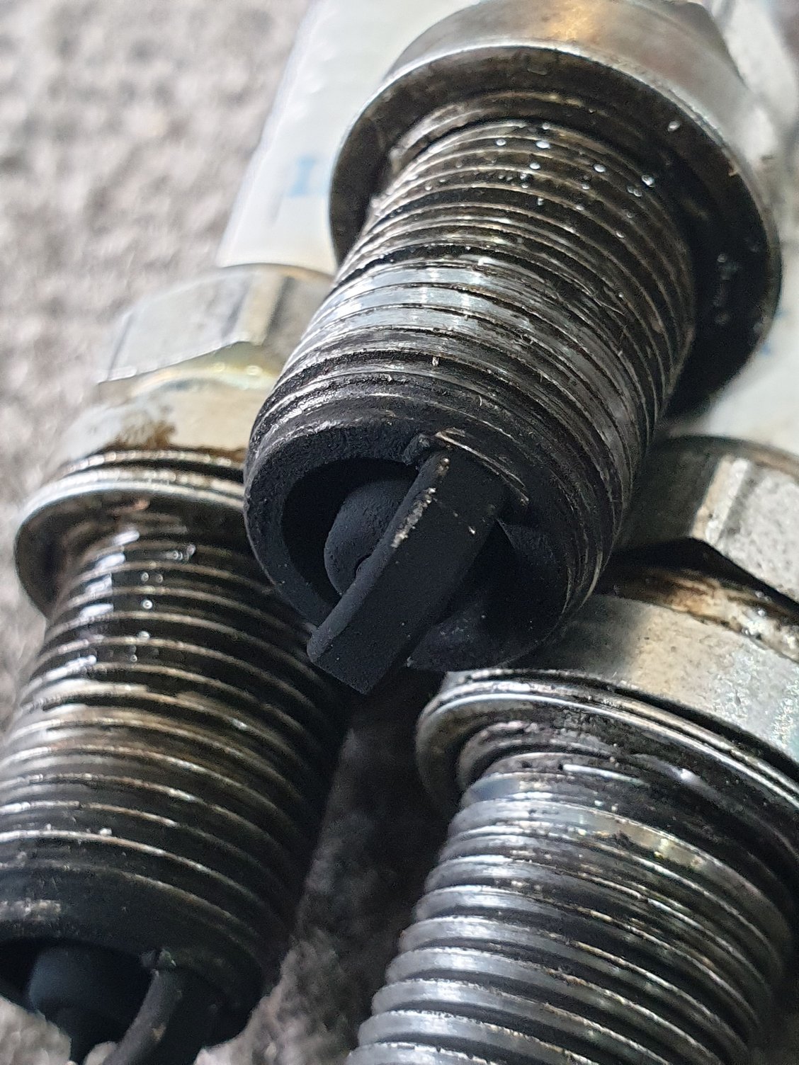

Driving home got restricted Performance light
lost all power engine running like crap
codes p1646 p1647 pre cat 02 sensors are dead
Checked plugs all 8 are Black as and engine very hard to start and only just runs
My question is there any other vehicle make that uses the same 02 sensors as the 4.2 stype or is there any other like the 3.0 v6 that use same sensors
Reason I ask is none available new in New Zealand brand new
so I have to get from uk or united States and now won't arrive till new year
As if a 3.0 sensors would work I would put second hand in just to have vehicle running over Christmas break
Thanking you

Without working O2s it has to run rich to avoid serious damage to the engine.
Instead it causes damage to the cats - but they're cheaper and also at least you can drive somewhere (make it close!! or cats will be needed).
IIRC people have posted Denso part #s. Denso have a lookup service IIRC.
