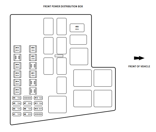

Two fuses to check, both under the hood:
#25 (This is a big 'un, as Al Bundy would say)

Going nuts trying to find fuse 25. Anyone know where it is v8 2002???

kr98664's Avatar
Posts: 4,905
Likes: 2,312
From: Oregon
Inboard side, at the front corner in the front power distribution box under the hood:
Old Dec 14, 2023 | 12:03 PM
Beretta9's Avatar
Joined: Nov 2023
Posts: 167
Likes: 32
Ok that’s what I thought was fuse 25 but for some reason it’s labeled 9 I think. I’ll check it out this weekend. Scrapyard has a fan with harness and cooloant pump all attached and in good condition for $50 might roll the dice since I’m leaning towards it being the sending unit on the fan but could there be a way the alternator is causing fan not to come on ?
