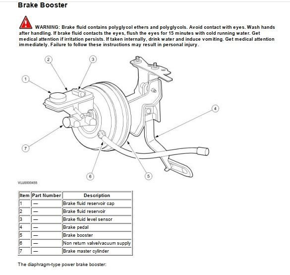

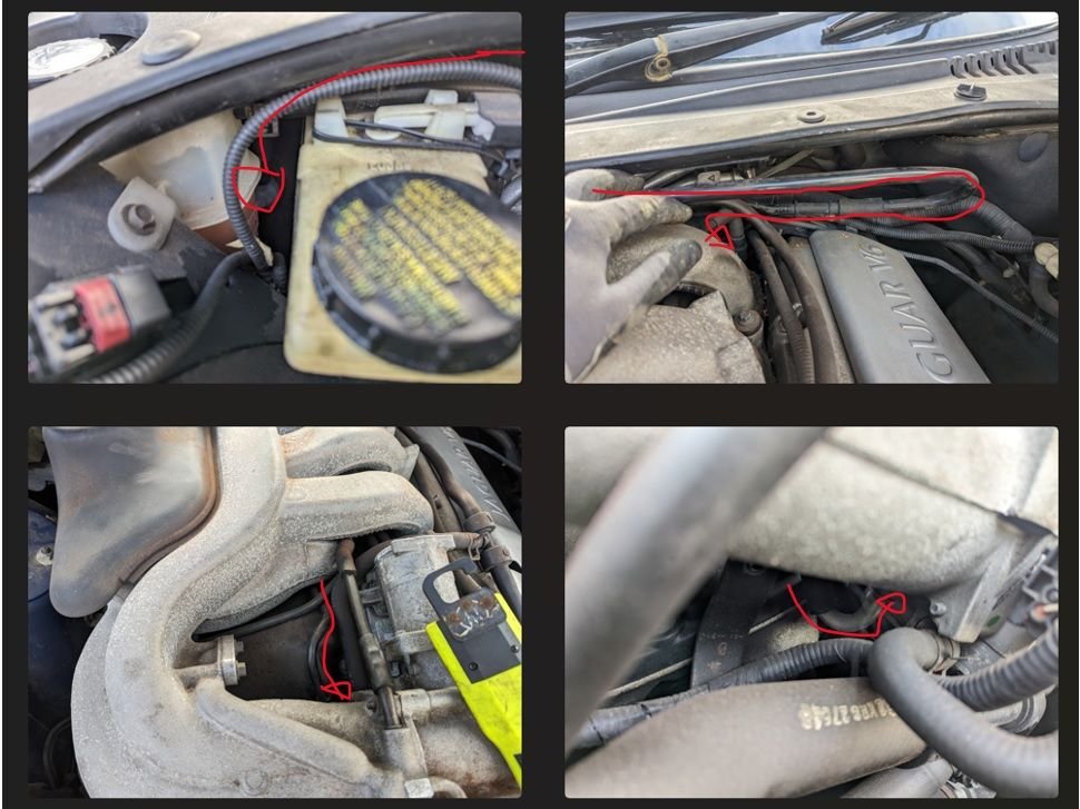

  1. Disconnect the vacuum hose where it connects to the intake manifold. Do not disconnect the vacuum line from the Servo. Air should not flow when pressure is applied, but should flow when suction is applied. If air flows in both directions or there is no air flow, the valve needs to be replaced. Interesting... there is no check value, but servo does not move with pressure , but does with vacuum. see image below of lack of check valve and route of vacuum pipe.
Verify Vacuum
  1. Check the operating vacuum pressure when the engine is at normal operating temperature. There should be a minimum of 18 in. of vacuum. Vacuum may be increased by properly tuning the engine, checking for vacuum leaks and blockages in vacuum lines. Passed 18in of pressure
The vacuum hose route looks interesting, I was expecting it to connect to the manifold at the rear of the engine, it does not, it routes to the front.
The route is clockwise in the images above. No check valve, I could add one in where the pipe meets the y join. Looking at the manual the check valve is where the hose meets the brake booster, not in line.
