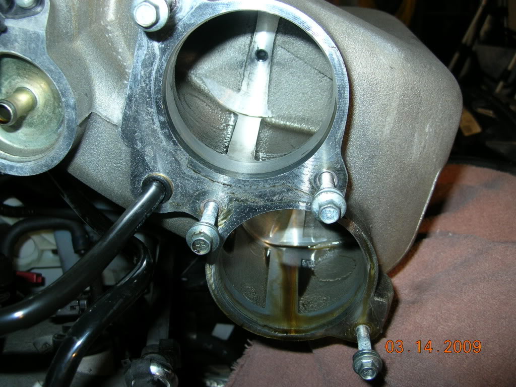

Ok if the IMTs aren't leaking, it still doesn't mean that motor oil is not "pooling" in the lower IMT chamber. In the picture below, notice the oil in the lower chamber, upon removing the IMT valve alot more oil poured out. All that oil works itself into the passenger bank of engine, often causing misfires.
Another simple check is to remove the #1 sparkplug (front passenger plug), use a flashlight and see if there is oil saturating the sparkplug well and base of spark plug (not the firing tip itself), but inspect the tip should be whitish in color.
You are experiencing a misfire on the #1,3 and 5 cylinders, all on the passenger side of vehicle. Of course you cannot check #3 and #5 sparkplug wells without removing the intake manifold.

A long time ago yesterday, Columbus found/did not find America. Yesterday, I found oil in my IMT chamber.
Looks like this mystery is solved...haha
Old Oct 11, 2011 | 12:32 PM
Jon89's Avatar
Joined: Jan 2009
Posts: 13,095
Likes: 4,753
From: Raleigh, NC
Welcome to the International IMT O-Ring Replacement Club for Men. Most of us who own the S-Type 3.0 are already members....
