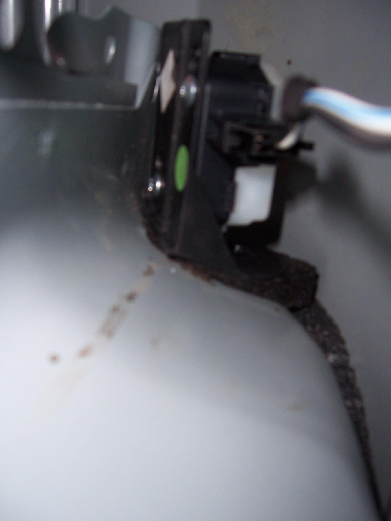

Like many other before, my filler cap pin broke on my 2006 S-Type. I have read this and many other forums for advice on replacing the part, but below is how I did it.
Part number XR857532 from British Parts UK (new actuator and pin)
1) Remove 2 x carpet securing screws/clips on inside RHS of boot and pulled back carpet.
2) Remove 4 x securing screws holding electronic unit in place. Then remove/pull electrical connector out of actuator unit
3) Remove rear driver side wheel (UK car) remember car supports - don't rely on jack
4) Remove plastic wheel arch lining. 3 x torqs, 3 x 10mm plastic nuts and 2 x push-in securing pins
5) Look up in arch and locate actuator pin housing at rear of Filler assembly. Note that there are arms with end latches top and bottom attaching the housing to the filler assembly
6) Using 2 screwdrivers, lift the latches on the actuator pin housing and pull it out of the filler cap assembly
7) Go to the boot and remove the actuator and pin housing from behind where the electronics box was
8) Remove the old actuator from the housing and replace with the new one - greasing it well
9) Replace everything in reverse order. I took the opportunity to wash the inside arch and wax-oil it first
Attached Thumbnails S Type fuel door latch-remove-electronics-unit.jpg   S Type fuel door latch-remove-carpet.jpg   S Type fuel door latch-actuator-inside-boot-1.jpg   S Type fuel door latch-acruator-housing-end-latches.jpg   S Type fuel door latch-actuator-housing-filler-assembly.jpg
