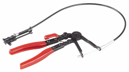

JagV8 is right but I found it a bit tough to install. I drained the coolant so it would not go all over the place. Yes it has an electrical plug and the hoses and clamps are a pain.
I have attached a picture of the special tool I used on the clamps. It's called a cable clamp pliers. Without it I could not get to the clamps with my normal pliers and had several that I could not replace the clamp after I got it off. They are a bit pricey at around $40.
