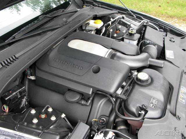

Micheal;
Which hose are you talking about? UFO is the big black disc?
I only see one on the passenger side of the STR?

This guy. Replacing the hose might be the best bet.

Ah ... not PVC hose (PVC - a kind of plastic), but PCV hose (PCV - positive crankcase ventilation).
Well, any hose making a vacuum leak is gonna cause grief...

Ah yes sorry about that. I am not sure exactly where the leak was, but once I put in a new hose it fixed it.
