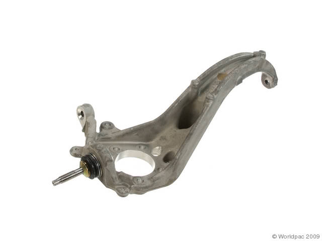

Originally Posted by qwiketz
knuckles- s type r is different (found out the hard way, unless my mechanic ordered a 98-02 one
MY 98-02:
In addition to there being a difference b/w 98-02 and 03-on, (Ball joint faces opposite direction) there is also a difference b/w STR and non-supercharged S types MY 03-on
MY 03-on
The STR knuckles are thicker and have threaded caliper mounting holes. The Non-S/C do not have threaded holes.
STR:
Non S/C, 03 MY:
02 MY:
