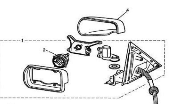

Start at a seam and insert your pry stick.
When I work with plastic like interior door panels I use plastic pry sticks. Harbor Freight has some cheap ones. That way when I pry it has less chance of damaging paint.
Here is my favorite tool. It's used by glass shops when installing windshield's. They call it a "Windshield Stick".
htthttps://www.kent-automotive.com/K.../P90150.kap://
Looks like this;
I have several and get one started then use another one to help it along. Just takes some playing around but it's not too hard.
This is from the JEPC which is free on this forum? You might find it useful?

Thanks. I had seen the JEPC and have some plastic spudgers (that are about the same thing that I was attempting to use and then backed off as I thought I was applying to much pressure- but I do understand the scene.
