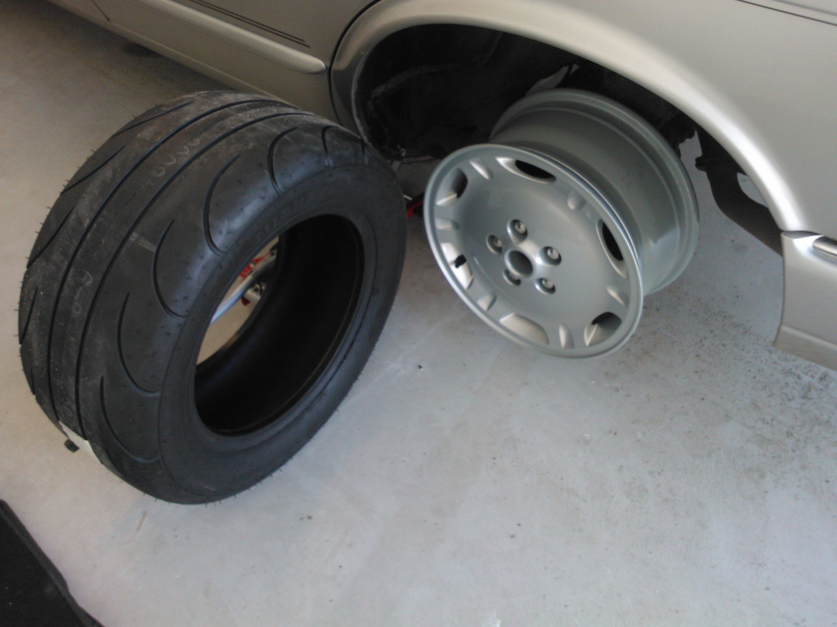

If that's correct, you have 330mm ( 12.9" ) rear disc. My XJR has 305mm and
I was able to fit 16" wheels to the rear. XJR front ones are 325mm and they require at least 17". I think you may just and just get 17" fitted.
Attached Thumbnails Smallest wheel size that will fit rear of STR-fat_tire.jpg
