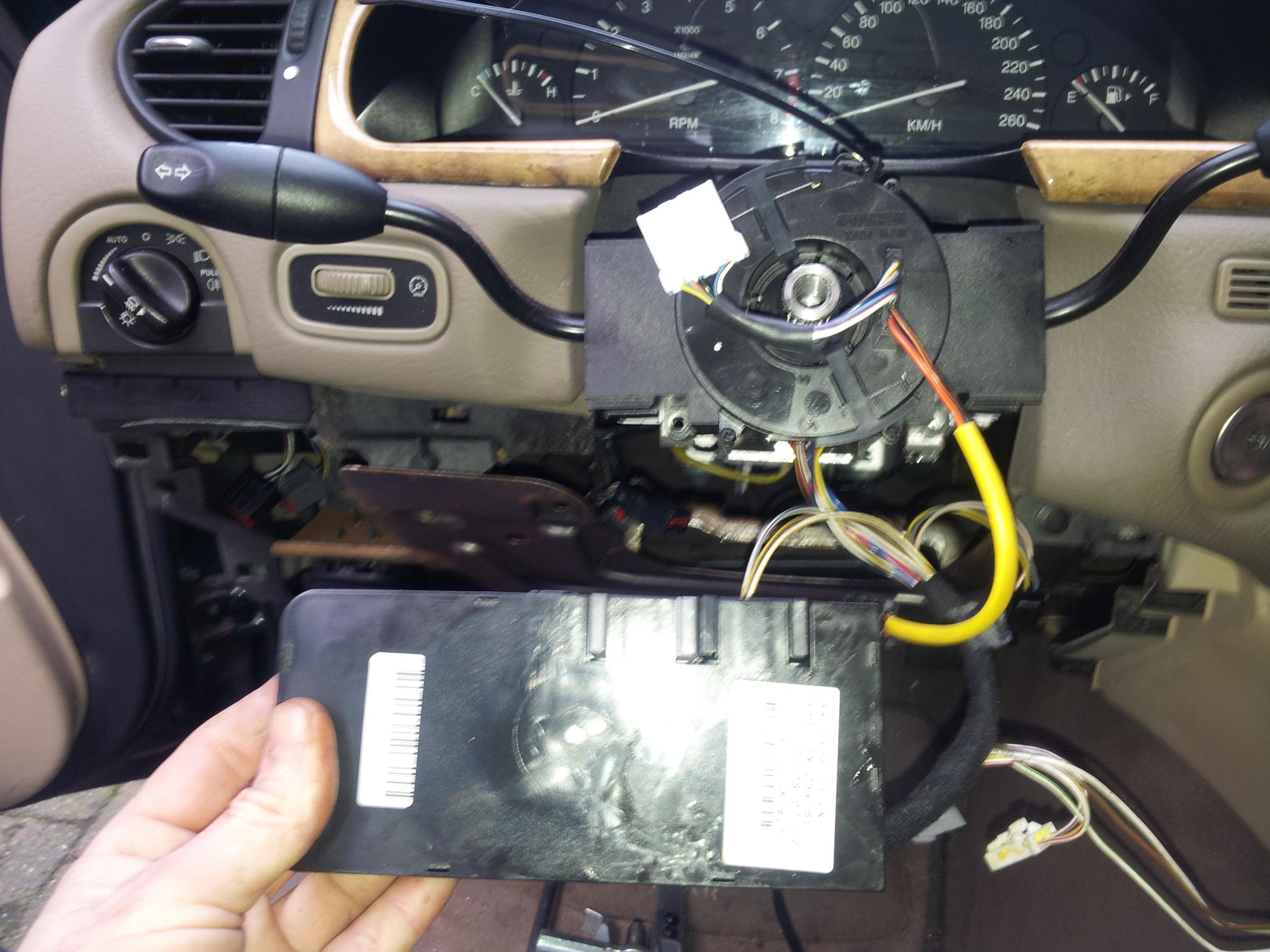

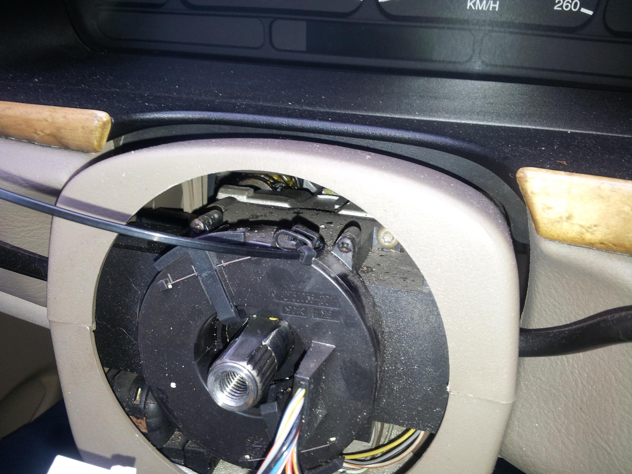

I took it out of the donor jaguar this afternoon and noticed it was a bit different from the how to FAQ where it is shown on a 2003 S Type.
Will try and post photo's later today.
Old Jan 14, 2014 | 02:36 PM
Jurgen Dimmers's Avatar
Joined: Mar 2013
Posts: 37
Likes: 5
From: The Netherlands

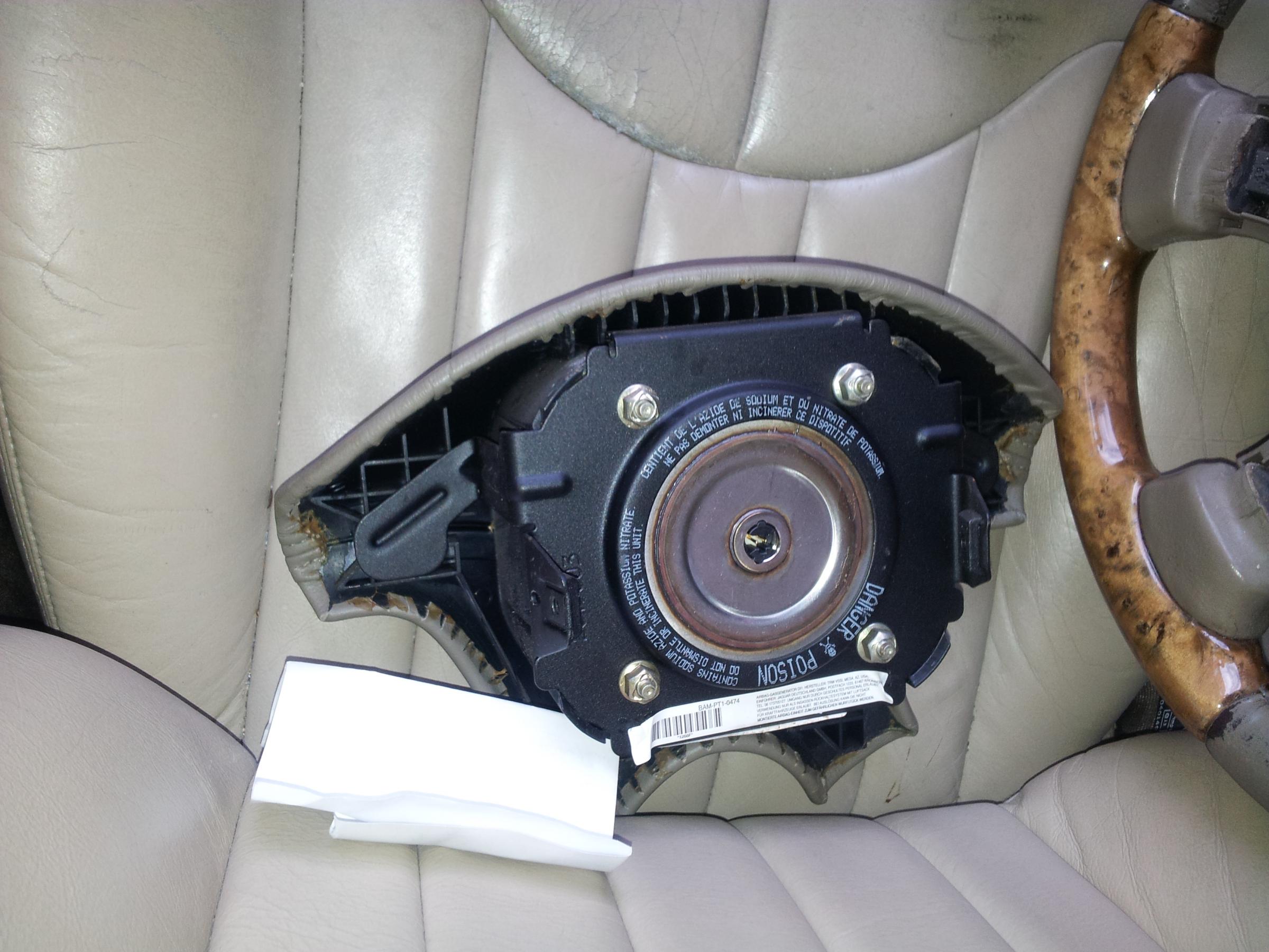

Firstset the steering wheel control to manual and make sure the steering wheel is all the way out and down. than disconnect the battery.
I didn't do that so had to hook up the battery again while I was taking the parts out.
In the back of the steering wheel are two holes covered by round plastic plates, they hide two 8mm bolds for the airbag ( you can see the holes in the steering wheel back plate. Take the bolds out and carefully pul the airbag from the steering wheel. There's a little connector slide back the yellow lock press two little pins on the side and disconnect from airbag.
next step 8 torx bolds inside the steering wheel 4 for the controll buttons unscrew these completely and 4 that hold the horn assembly to the steering wheel. they only need to be loosened than take out the buttons and assembly in one peace.
Next remove two phillips screws holding the steering column covers and take them out. disconnect all the connectors you see
and your already at the part needed the clock spring, I used a tie rap two secure it just in case.
Unscrew the four torx bolds attaching the spring clock to the steering column
It looks like there are two black connectors on the spring clock but those two are fixed, you have to remove the clock with all the wiring you see running in to a black box that is clipped against the steering column.
unclip that box, remove 3 connectors at the left side (big black, grey and small black) and take it out.
Now carefully slide the clock spring of the steering column and your done. it's out.
follow reverse order to put it back in.
