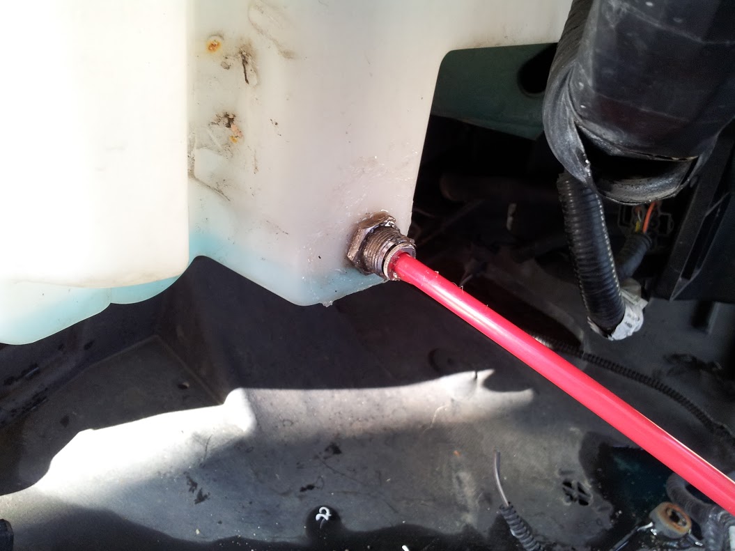

When taping into your washer reservoir, I went right next to the pump pickup. Mine was half full, so I used a stepper bit to 9/16 to make the hole. Make sure to have a bucket handy to catch the washer fluid.
The hard part is getting the bulkhead fitting through. Stick the red hose through the the hole you made and feed it up through the top. I found using a wire hanger straightened out, helped me to direct the hose through the fill cap. Stick the hanger into the hose and push up at the same time to get it out through the top.
Now comes the fun part! Put the bulkhead fitting onto the hose. S L O W L Y pull it down and out the hole you drilled out earlier (you also remembered to put a nut on it right?). It should look like this
And if you drop the fitting in the tank like I did (3 times!!!) the easiest thing to do is pop off the pump to the left and fish it out that way. Plus it is a good time to clean the screen on the pump

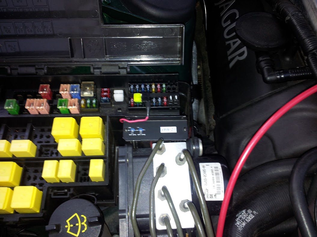

Mounting the box
I decided to stick it between the ABS pump and fuse box, a bit of a tight squeeze but it fits. Plus you can run the power from right there.
Ground for the box (hard to tell with wire loom on it)
You will have to make a cut into the lid to close it though

If you bought the MAF one you need to tap into the green/white wire. I'm not a huge fan of these connectors but I did it for now.
