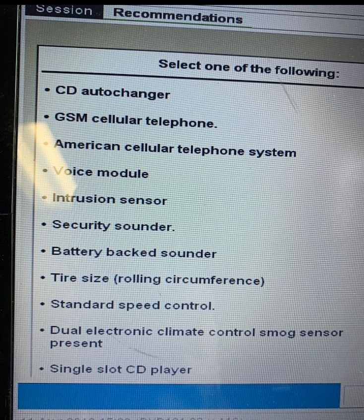

If u have SDD I bet you could disable it! I know it has an options menu where I can add or unistall that option
