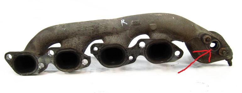

That's the big question. Will they add any power? As far as fit the EGR tube is definitely needing modification. The Jag has the connection up high and the headers have it down closer to the collector. Looks like the same flange connection but in a different place. The header does come with an extension for the EGR but I don't know why?
If they are stainless steel do you still need to coat them?

If that's what the stock exhaust manifold looks like, I guarantee those headers would be a horsepower gain. The long separate tubes prevents exhaust gas pressure waves from being pulled back into ajacent cylinders when the exhaust valve opens.
If they fit an STR, I'd cut off that small collector and weld a reverse taper megaphone in place to help scavaging too.
First of all, the extension is made to connect the EGR, where is suppose to be, closer to the top much like the factory manifold showed in your picture. Second the coating is mainly to keep the excessive "heat" out. Our car like all the cars today have knock sensors, so if the engine was to get too hot the computer will sense it, and retard the timing... This is to save the engine from detonating, which is absolutely bad. The good part is that this will save your engine, but the down side is this will cut the power too. So having in a long tube set headers will increase your power but as heat build up inside the engine bay your ECU will cut back the power. So what’s gain is lost too.
From my personal experience in my Northstar Fiero, by replacing the stock headers with "long tube" (31inches), made me 30hp average across the power band. Definitely good. But the N* is a NA engine, my best guess is that a Boosted engine like the one in our STR’s will gain this much, but is more likely it will be more than a NA engine with similar size. I will not be surprise if a 40Hp showed in a Dyno graph! =)

Agreed 100 %. Stock cast iron manfolds are the biggest killer of performance on these engines. I've never seen what they looked like until that pic was posted. (Too busy to even look at mine) Boosted engines need all the help they can get getting the exhaust out. NA engines benefit from a tuned header to help pull the new air/fuel charge in- get too big or the wrong length and it doesn't help pull it in. Dirt track Late Model engines (374 cu in making 800 hp) that I've done gained 25 hp from tri-y merge collector headers.

Those cast iron exhaust manifolds pictured are from a Lincoln LS, not an STR.

From: North Aurora, IL
They are almost identical
