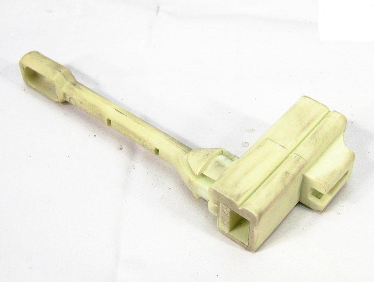

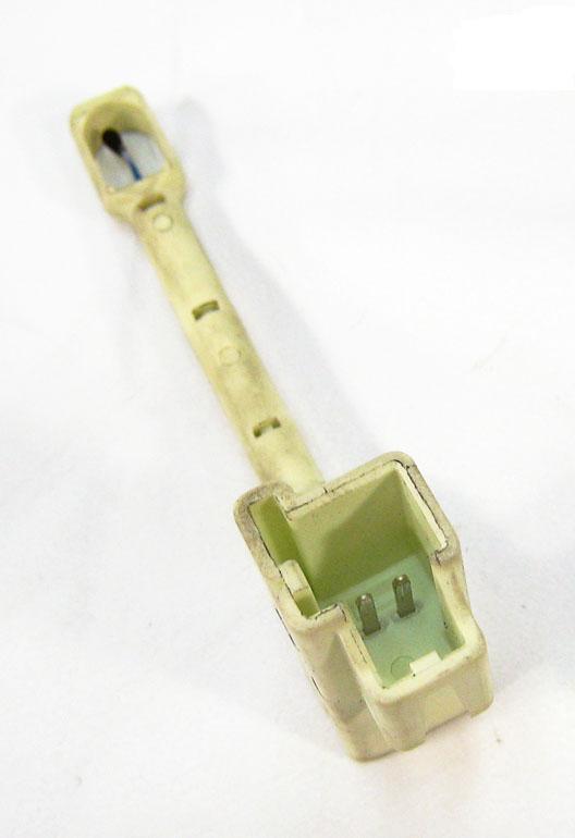

All the evaporator sensors (there are 3 not 2) are the same. You can pull them out and check the resistance. They should all read the same. If one reads different swap it out.
The good thing is the sensors are not very expensive and of course they are identical to the Lincoln LS ones which means it's a Ford part.
Now getting to them and getting them out is a bit hard because they are up beside the evaporator so look at the gas pedal and go straight up and to the right. They are white plastic and you need to unplug the wire plug first before removing them. Same position on the passenger side. We have several good threads with pictures showing where they are.
It would be worth your time to find them. The part numbers for the temperature sensor is listed too.
Be sure and clean the in cabin temperature sensor as suggested above. Mine was dirty and it did help cleaning it. Be careful and use a Q-tip wet with solvent.
I did not see where you have checked that the car is still draining water out the A/C drain? Do you have a good sized water puddle under the car?
Any chance that it might be plugged up?
Is your outside temperature reading correctly?
I have attached some pictures to help out. Note the Lincoln LS drivers side has two temperature sensors (yellow arrows) and the passenger side has one. Again the same as the S Type.
I have also attached the sensor picture so you can tell what it looks like.
