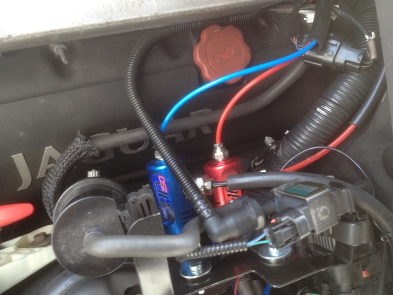

Two solenoids for N2O and fuel
Fuel line to solenoid, taken from the fuel rail

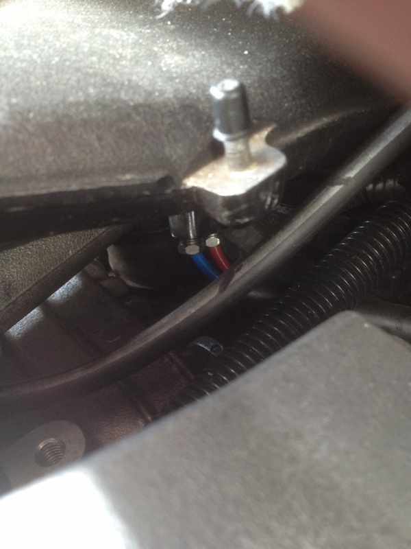

Pair of spray nozzles mounted in the intake pipe, just before the throttle body, one for fuel, one for nitrous
Different angle on the solenoids

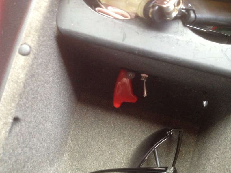

Master switch in the center console
Trigger switch under the accellerator pedal
Very simple, turn it on, and put your foot down.
