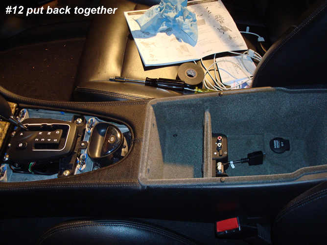

good stuff here.. btw.. what do i look for if i want a factory system that will allow direct ipod connection?
i understand ill certainly have to buy parts etc to do so, but still.. any word there?

Easy and cheap: plug it into an FM transmitter.
Expensive: get jag's ACM.
Plenty of threads, just search on ipod

This thread might help you? https://www.jaguarforums.com/forum/s...-type-r-36578/
And have a look in the XJ X350 forum for the ACM, big thread about it.
Great stuff so far guys thanks a ton.
This really helps me narrow my searches and become more proficient in my shopping and learning thats for sure..
It's SUPPOSE to be in the center console, not to say people haven't mounted it elsewhere...I bet you could look at a dozens of STRs for sale and never see one...The parts are expensive but it's also super labor intensive, it's a lot more than a few splices...You have have to remove nearly a third of the interior...lol

The stereo thing is probably the least import aspect if driving the car is what you're all about. But it's also the most vexing. The non Nav equipped cars tend to have the fewest options on them and are more rare. The Nav option also completely changes how you control the rest of the car. I simply don't use the Navigation part of the car. I'm old school and I don't get lost easily plus I prefer to map out my routes ahead of time on trips anyway. I agree that this Nav system is not very easy to use and so we don't ...
Then there's whole map update thing. It's $200 for a new DVD and forget about finding one cheap that's current and will work. There are endless DVD bargin hunting threads on here and for the most part it's usually someone who got lucky and found a legitimate copy for $100 or so.
Mostly likely you will end up with car with the Nav screen which means that your audio options are greatly limited but completely horrible either. There are a few people on here that have enhanced their systems (w Nav) if you want those killer window glass flexing capabilities.
The ACM (Jaguars audio interface module) is $200-$300 from a dealer. It does open the audio system up a bit and with excellent sound quality. The FM transmitter thingies are junk if you're at all an audiophile. The ACM will work with the Ipod but from what I observed you lose any Ipod based control capabilities and the audio system DOES NOT closely integrate with typical Ipod or really any mp3 player capabilities. I'm not an Ipod user so let the experts fill you in on the details. I picked a nice Sansa mp3 unit and I use that with FLAC audio mode via the aux-in capability also present in the ACM. That produces really great CD level sound and I can use the mp3 player to make selections. The ACM will also allow USB input from flash memory. Except on my car (very long story) LOL! Personally, if you have the Nav I think the ACM is a requirement.
There is a V2.1 firmware for the ACM which unlocks the controls on the iPod, so that problem is bypassed. Yes the controls through the touchscreen & steering wheel are limited (it emulates the CD changer) but then you can select tracks on the iPod itself. No problem. The ACM is the only means of getting digital quality audio into the factory head unit.

The Nav based stereo has no aux-in unless you get the ACM. That's the bottom line.
Neither does the non-nav OEM system.
As you can see from my sig, my car has the factory SatNav / Touchscreen, and I have retrofitted the OEM Bluetooth, ACM, and OEM Premium Sound. This is one way to go about it.
The other is to rip out the lot and put in an aftermarket double-din with all the fruit; Nav, Video, Bluetooth, etc. get yourself a couple of amps in the trunk, and new speakers.
