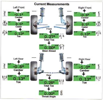

Installed H&R springs & factory CATS shocks myself some 20K miles ago. Have worked flawlessly and even more so once the alignment was done properly according to BRUTAL'S specs.
See attached...
See attached...
Take it that geometry set up is for the left hooker..?.. and simply reversed for us brits..?

I attached the alignment specs per Jaguar. Lowering will change things a bit so a good alignment shop will work with you to get it right for you. The difference with right hand drive is in Caster and Camber. Toe is the same.

BlackX300VDP - you know those are 3 copies of the same file and are Front only?
I love the way they're not symmetrical (mirror image, if you will) for LHD & RHD!! Our roads must be a different profile to yours or something. hmm.
