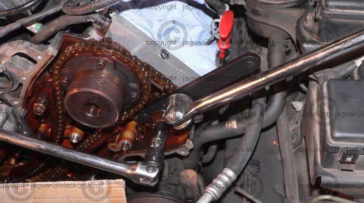

You need to use the Jaguar Timing tool. Sorry I don't have a great picture of it but take a look.
I have another set of install instructions but the upload limit is 5 MB and it's 5.9 MB.

Yes the flats should lineup that is the reason for the tool that is bolted on top of the cams so they are in sync.
Link JagRepair.com - Jaguar Repair Information Resource
Link http://jagrepair.com/images/Training...des/168_sg.pdf
