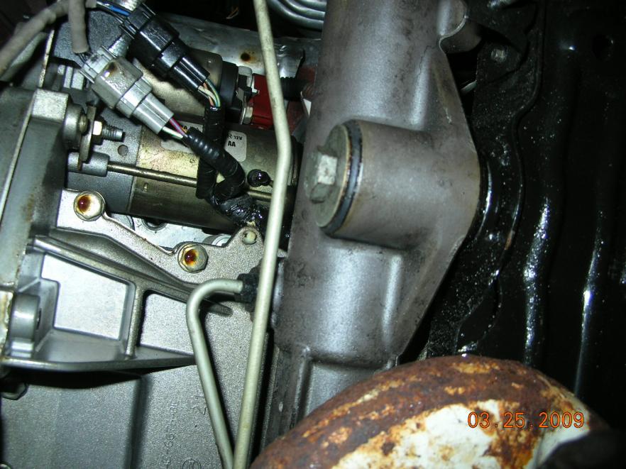

Update, I have replaced the yellow IMT O rings (with the green 1's), pass. side valve cover gasket(s) and upper intake. one of those were a problem, but still leaking. Looks like jag_genius "knew" it. I am looking at replacing the oil pan gasket. I have looked at all the oil pan gasket replacement posts but all seem to be on an X. Any advise for an on my back with jack stands wrencher for the S? Alldata says about 4 hours start to finish. Also any guesses as to why the yellow numbers (6-16-07) are painted on the pan?

Yellow paint meens junk yard motor, ECEPT THEN IT SHOULD BE YR/MAKE/MODEL, NOT DATE. SO MAYBE IT WAS THE LAST TIME THE GASKET WAS DONE. IF ITS BROWN, ITS ORIGINAL, BLACK, ITS BEEN REPLACED and you have to jack up engine, and drop the steering rack from the subframe...uh yeah all on your back...glad its not mine, OH AND YOU HAVE TO HAVE IT HIGH ENOUGH TO TURN THE PAN PAST THE OIL PUMP PICKUP TO GET OUT

Thank you for the quick reply Brutal! I kinda had the idea she was a boneyard motor. SUCKS to be me (all the way around). Mums the word lets not tell the wifey. Well, whoever replaced the motor did a good job at not hacking wires, looms and all.

The conculsion of the story. It appears that the oil pan gasket need replacement as well. I started oil pan removal Thursday night, 3 hours to remove pan from motor. Drank some beers and patted myself on the back! Friday installed new gasket and pan, filled her up with lube juice 2.5 hours. Crossed my grimmy little fingies and drank more beers. Here it is Monday morning and NO lubbie juice on garage floor (no beers til later). I conquer with Brutal that the yellow date numbers were when the gasket was replaced and hopefully not a boneyard motor! All in all for 5.5 hours of my time and less than $75.00 in parts (cursid oil and filter price), I would do it all over again! I believe that I could actually do the job in 4 hours, as I now have found a couple of tricks. Oh yeah, did the job on my back.
