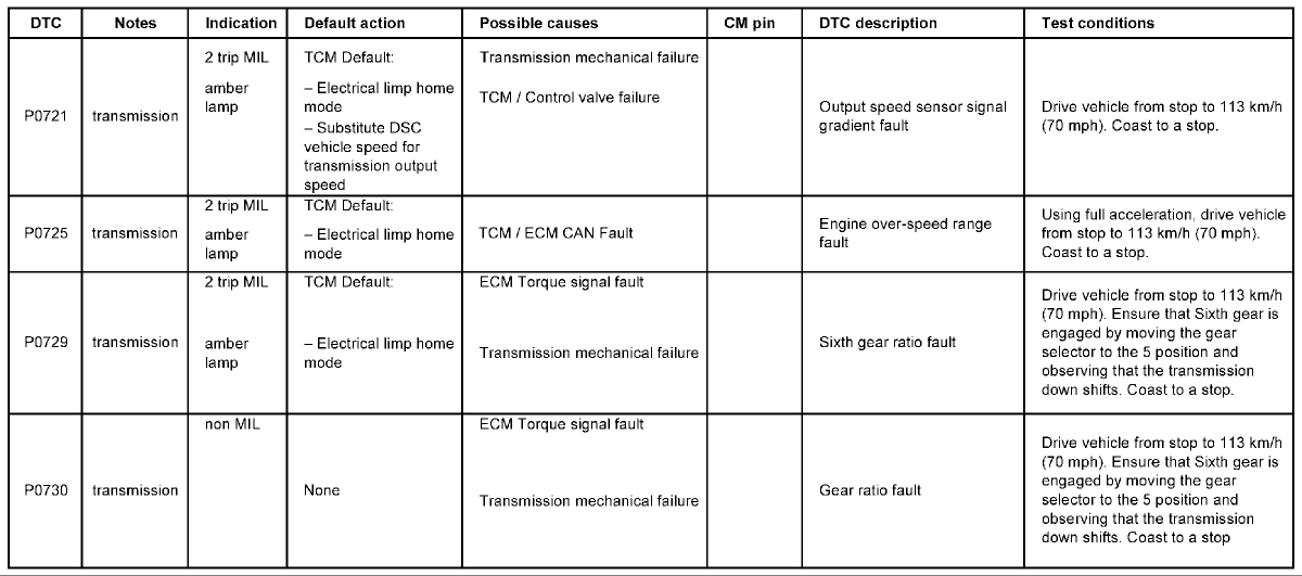

okay so the codes are “P0730 Incorrect gear ratio (TCM))”
and
“P0829 Gear load 5-6”

From: Dallas, Tx
and
Code explanations
Tom
