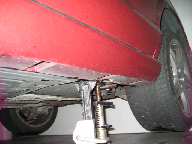

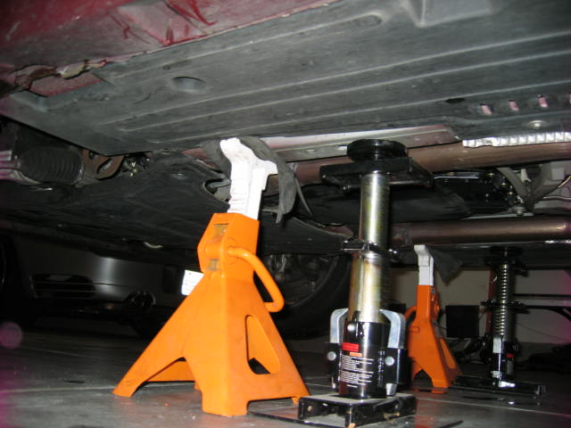

#2 Jack up and level car: use jack stands at the front on the two “beams” that run from the engine to the transmission. Used the metal “triangle” where the rear sub-frame attaches to (points suggested by JTIS). I used standard jack stands up front and sears lift and secure on the back which has a screw top so I can adjust the height to make it level. Measured with a gravity angle indicator on the driver door still (with the silver Jaguar logo) and on top of the firewall under the hood.

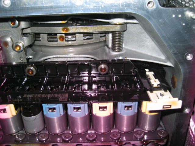

#6 Replace connector sleeve. This parts seems to be prone to leaking and should be replaced proactively. The three dealers around my house stock them but only 1 had it in stock. They get a few of these in each day. Disconnect the cable connector buy twisting and pull out (there is another wire that goes to some other connector that should be removed so you can move the harness out of the way. See photo but there is a white release slide, push in the release pin and pull down. Reach the sleeve from the outside and pull out. Lube up the seals on the new one and slide in. May have to rotate it around a bit but when you get it lined up, it should slide in with a pretty snug fit. When is in, push up the white disconnect until it clicks. Connect the connector and rotate until it clicks and reconnect the other connector on the harness

Some additional pictures comparing the old and new sleeve (the old red one came out without any friction, the new one had to be pressed hard to replace. Another photo showing the difference between the old jaguar pan and the new zf part. One showing what the transmission looks like with the sleeve removed. Last two just shows where to jack up the car. The second pair in the photo is just a backup and doesn't touch the car.

ID:	2163   Click image for larger version
Name:	sleeve removed in tran.JPG

Name:	front jack up.JPG
ID:	2165   Click image for larger version
Name:	rear jack up.JPG

Guess you can't change the pics. Here are the correct ones showing the connectors connected and the sleeve connector closed
Attached Thumbnails ZF transmission oil and sleeve change writeup with pics FAQ-new-connector-connected.jpg   ZF transmission oil and sleeve change writeup with pics FAQ-img_5453.jpg

On the other hand, I have two of the lift-n-secure lifts + 1 other standard jack so it took about 10 min to get in up on the stand (with two people, front to target height in one shot then back to target height in one shot). I also have a large piece of rubber sheet left from building my pond that made clean up a bit easier - transmission will drip for a while with pan removed - I don't have a bucket that fits under then entire area.
