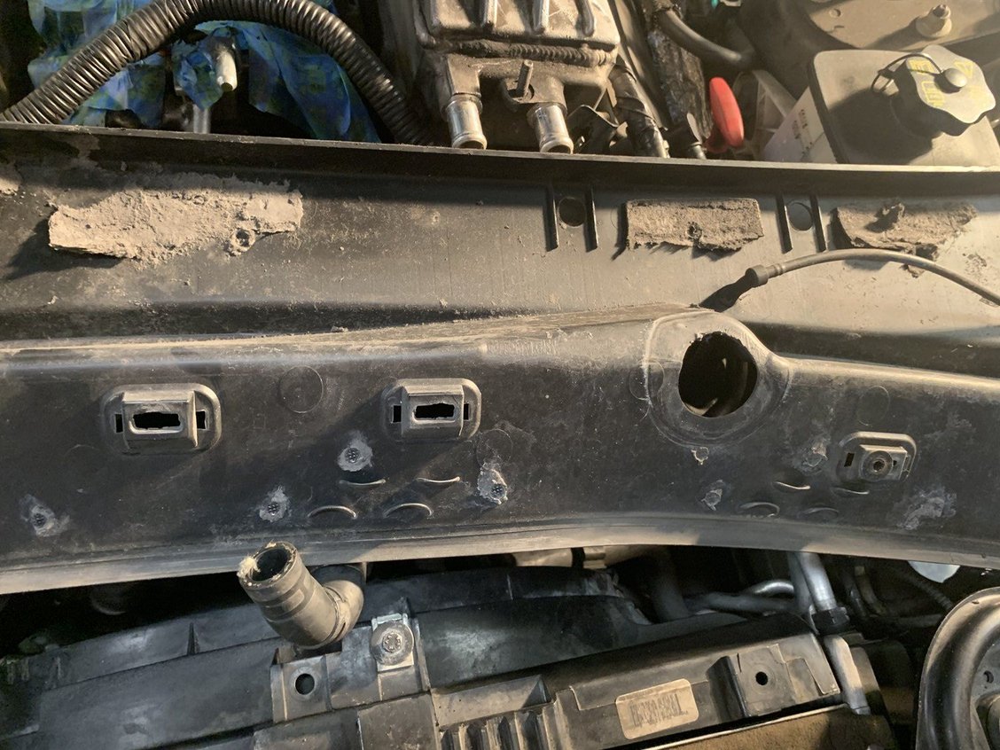

Today I removed this after the cowl, plastic fascia piece and it's basically just paper and in complete tatters. I had a windshield replaced by the dealer about 5 years ago and it looks like they over tightened one wiper arm and left some anchor base pieces out plus a seal I think.
So I guess this is meant as sound insulation? It's not terribly robust.
Is it worth replacing or not?
Did anyone do something different?
Spray something on it to help preserve it?
Lots of mess to clean up, perhaps a bird's worth of feathers and crap.

Hi Staatsof
Mine had no insulation under the plastic cowl. But it is 20 years old and I've owned it for 5 years so it could have gone long ago. Is this insulation directly under the cowl or, part of the firewall?
Perhaps it was meant for temporary protection of the cowl part only. Something used as keeping a new part in good order prior to selling or, when they replaced the windscreen. Post a picture, if you still have it, and someone might recognise it.

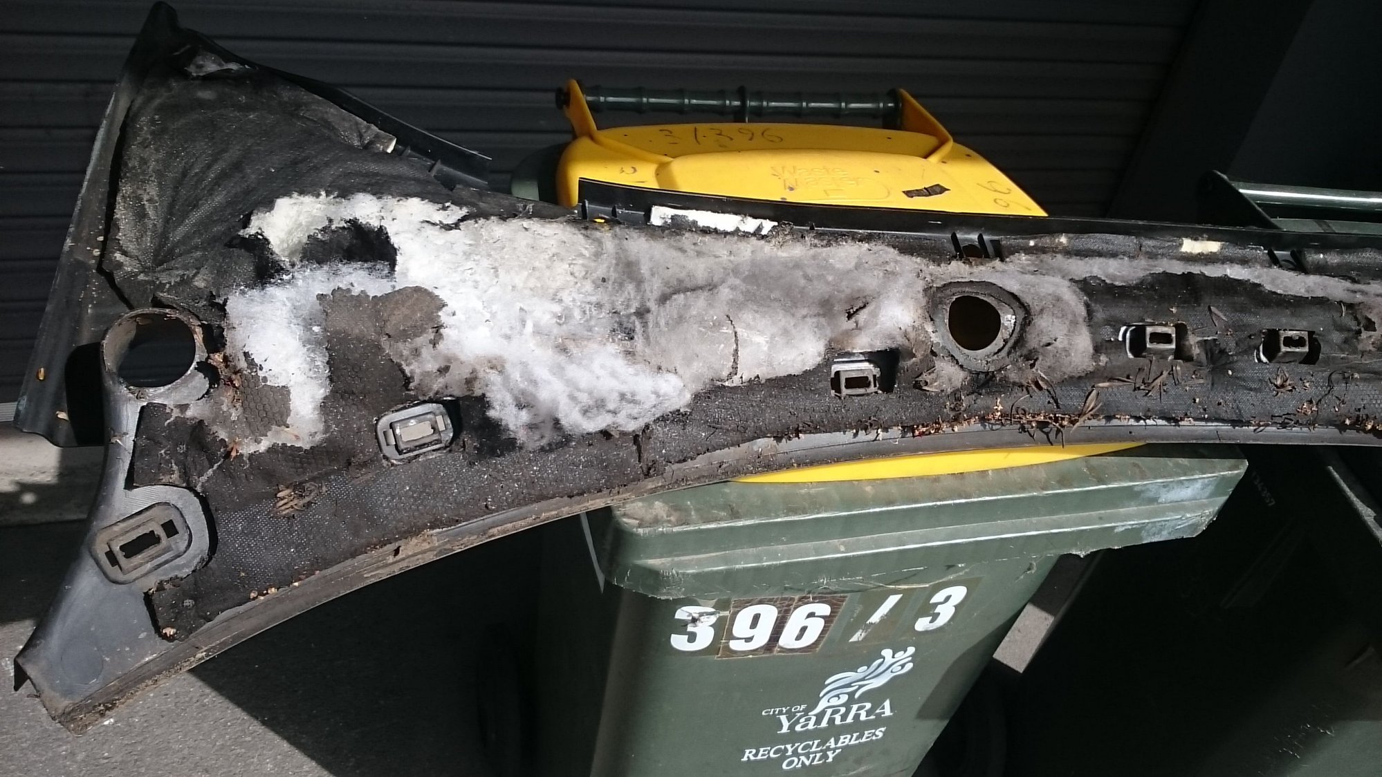

I would definitely replace some type of insulation layer there.
I removed this plastic cowl as well from the vehicle recently to replace this insulation layer that was hanging down and had to drive the vehicle without the cowl at one stage. The noise level on the freeway was very loud and irritating even though the whole cowl was removed mind you but the plastic cowl on its own would still allow heat and noise to penetrate which I would find annoying..
I did recently post on this problem with some photos:
https://www.jaguarforums.com/forum/s...m-trim-217166/
One of the members (kr98664) suggested a heat barrier adhesive backed product but I was conscious of the weight of the whole thing and whether the cowl would click back into place.

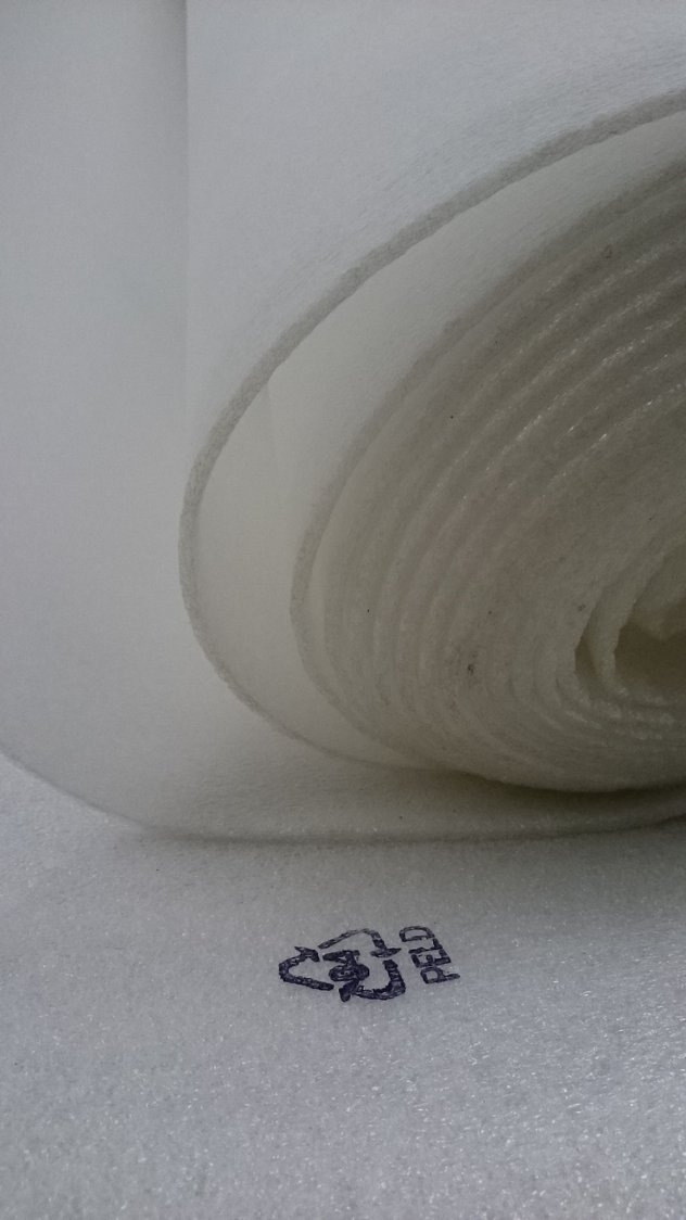

I am still in the middle of re lining the cowl and have settled on of all things a surplus amount of an Ikea roll of many meters I had in the garage and had to use as an underneath floating floor insulation. It has a recycle stamp on it of 'PELD 04'. Its a low density polyethylene. It does have a very high flash point of 644-680 degrees F and will melt at 230 F. I plan to adhere it with a glue in the same spots as the heat welds of the old insulation.
I do suspect all latter S - Type variants had this insulation layer; perhaps even the earlier types. It appears that it was a fibreglass composite, but with very poor longevity properties...

So the question is ... does the original cowl piece come new with this insulation applied? That might be a whole lot easier except that it's probably the same crap material they used originally just like the hood liner and all the plastic cooling system bits.
Thanks for posting the photo of that mess. Sorry you have to deal with it. There was nothing stuck to the backside of mine but then maybe they just cleaned it off when they replaced the windshield and just left the old junk there?
Or a mouse ate it all LOL!

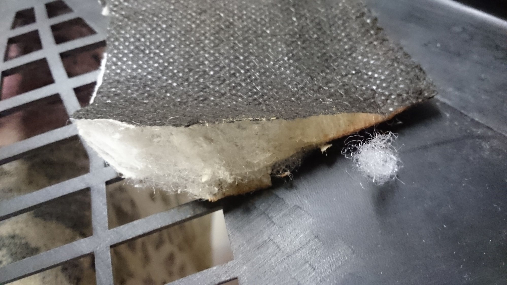

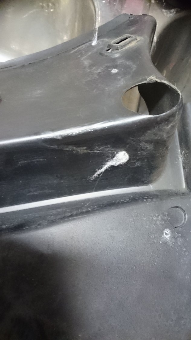

Moisture kills this
Synthetic fibres
Thin synthetic top layer
Heat pressing spot weld
You are right Staatsof, there is definitely no glass fibres but it is definitely not paper based either. It is an 'insulfluff' type synthetic insulation with a thin synthetic black top protective layer. Hardly any protection, its is such a poor design in that the top protective layer is not wrapped around and tucked in underneath so will easily fray on the edges. Deterioration from moisture appears to be its biggest problem. Another pathetic attempt at building some longevity into a car...
I did not see the earlier post about the low cost and apparent spares availability to buy but I dare say unless it is an improved design to what was on my car it would only be useful as a template to use another material. I wouldn't waste my money.
Suitable alternative?

Mine looks nothing like that. Honestly it's just paper ...
I think a different MY and model may have something to do with this. Mine has cross strut bar to add rigidity so already we're different.
Mine, what was left of it, was stuck to the car and not at all to the plastic cowl cover. But I wasn't the first mechanic in there due to the windshield replacement. One fastener lock (threaded plastic part) was missing and stuffed into another opening so two were side by side?????
Clearly corners were cut ...

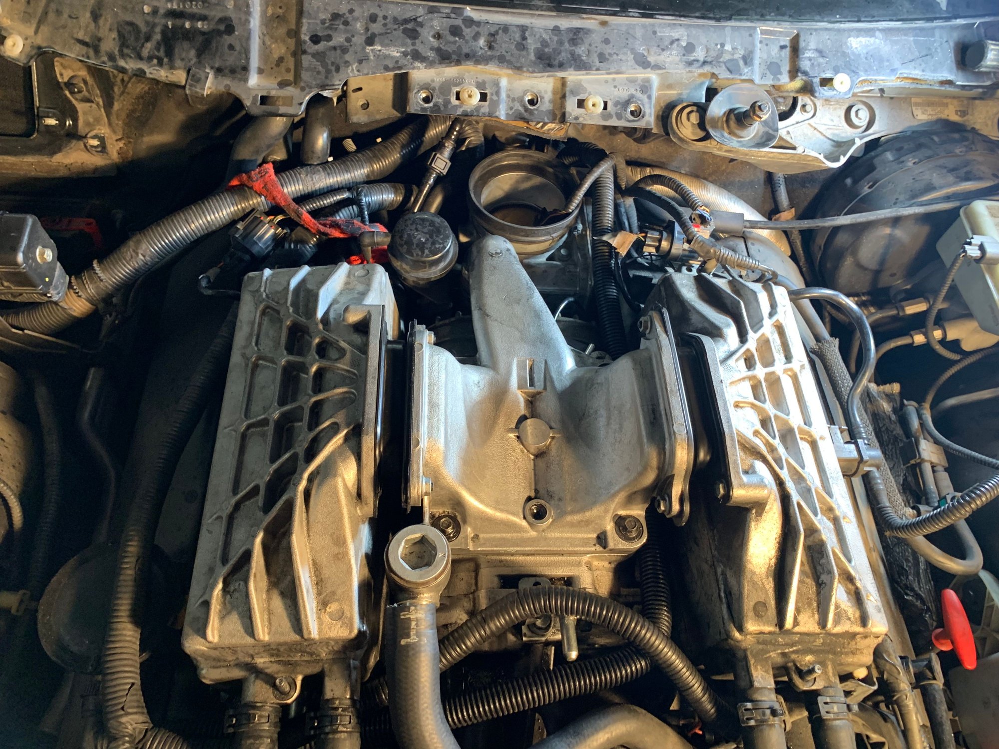

I just removed my cowl. My insulation has a thin black plastic sheeting over it and its not attached to the plastic cowl. It looks like it was on the bottom of the metal part below the windshield. You can kind of see it in the pic below

I'm not seeing anything? What I do see is what the paper insulation covered on mine.
Looks like yours has already been removed.
I think you're mistaking firewall insulation, different stuff

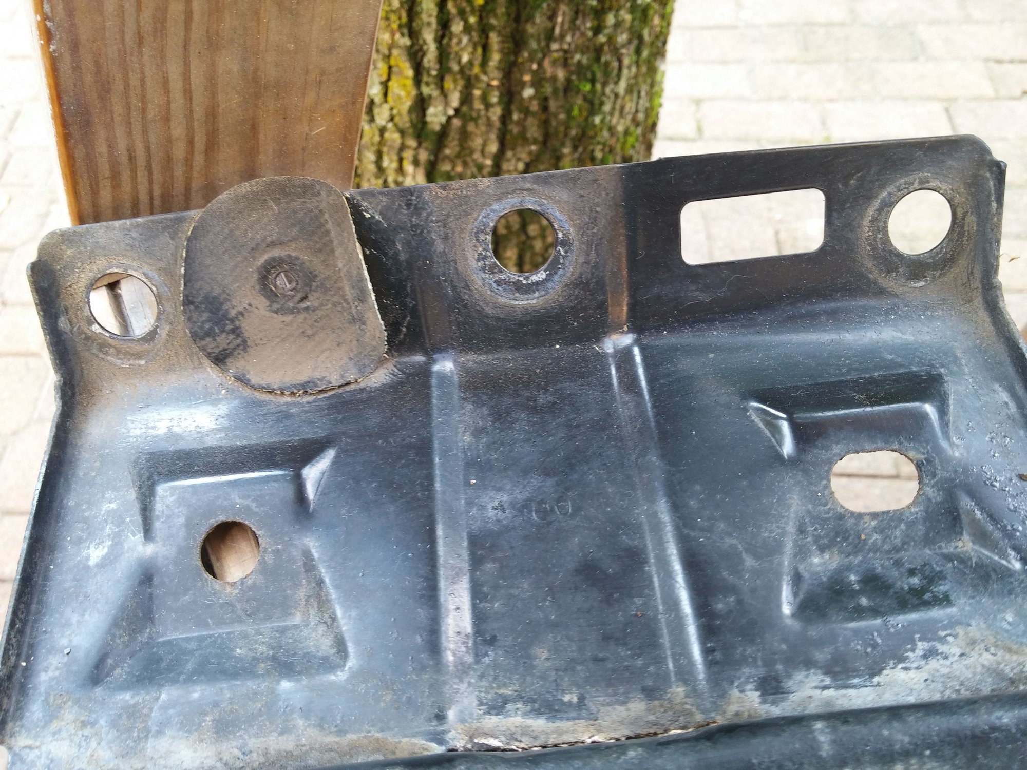

On my car just to the right of that wiper post I have one and only one large rubber/fiber washer. I'll post a photo when I get a chance. I wonder if more should be present. None of this stuff is in the parts diagrams ...
Here's a photo of the center area of that brace from my car. Notice the big rubber/fiber washer. I think it needs at least one more. Nit sure about the larger bolts though. A rubber washer there would interfere with the torque required.

Mine looms exactly lime that. Only one

Mine looked exactly like that, I patched it up with a foil tape a couple of times but ditched it altogether last time. (The insulation not the cover)

My cowl/windscreen finisher had probably not been removed for 10 years but that area will get more attention now.
Good to know the whole thing does not need to be removed to change the filter. My dirty filter came up well after careful cleaning (vacuum cleaner and soft bristle paint brush) so I wont replace it, probably only the second filter in the cars life; its a Ford part.
Definitely not an easy area to seal well you're right, my Citroen C5 (X7) has an amazing seal against the windscreen glass in the same area, it really does look like the windscreen finisher on this French car is glued to the windscreen! Its a later car design to the S Type and a beautiful car but I can say the S Type is a far higher quality vehicle but expected as more expensive when new.
I always park in the shade under trees so leaves are an inevitable problem. After 17 years the cars paint is still excellent but I do care for it, the car has only done about 68 thousand miles. I'm the second owner and I have done about 45 thousand miles.
Mine also had most of the debris in front of the cabin filter box and that drain was nearly clogged up. Vacuum cleaner, some warm water and a long handle soft bristle paint brush cleaned things up well, both drain holes fully operational.
Sounds like your windscreen boys were a bit rough and ready...
https://www.jaguarclassicparts.com/u...finisher-lower
As per Jaguar factory sales site above there were 2 types of windscreen finisher. Let me know which one looks like your later model S Type R. Also I would be very interested what the replacement insulation looks like. Jaguar obviously cheapened it for sure in the later cars; using a paper the area??
Not one insulation panel available from the dealers here in Australia. I would have to wait for them to import from the UK! And at the usual rip off Australian price of $67 I would rather spend the money on something else for the car.
I did want a new one to use as a template for another material...

So my plastic piece does NOT have any insulation under it. But it used to!!
