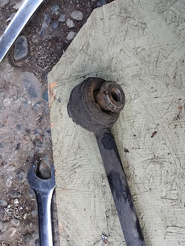

Joke's on me. Front hydrabushes shot, plus 1 front wheel bearing. In the rear, pretty much every piece of rubber in the suspension is gone especially the torque control rods. I hoped those would have aftermarket bushes but nope, gotta buy the whole thing. I've never seen so many bushes cave in a car, and I drive vehicles 30 and 40 years old. I guess Jags deserve their reputation. Replacing the torque rods, hydrabushes and wheel bearing first, and that should take care of 90% of looseness in steering. Over time will replace the lower rear control arms and shock bushes. Midas gave me a quote of $6600.00 to fix everything.

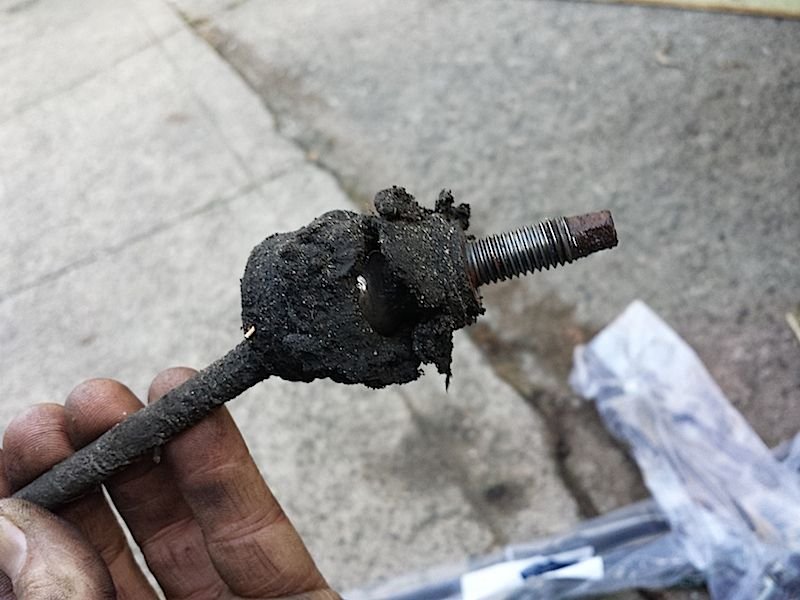

Torque rod inboard end

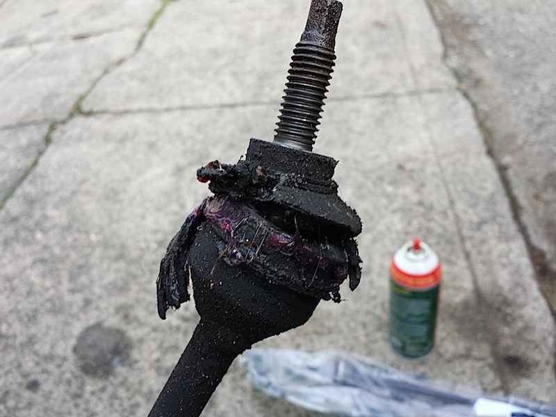

Torque rod outboard end

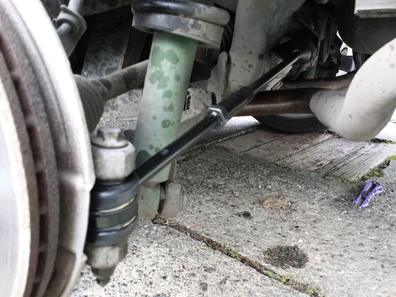

New Torque rod installed

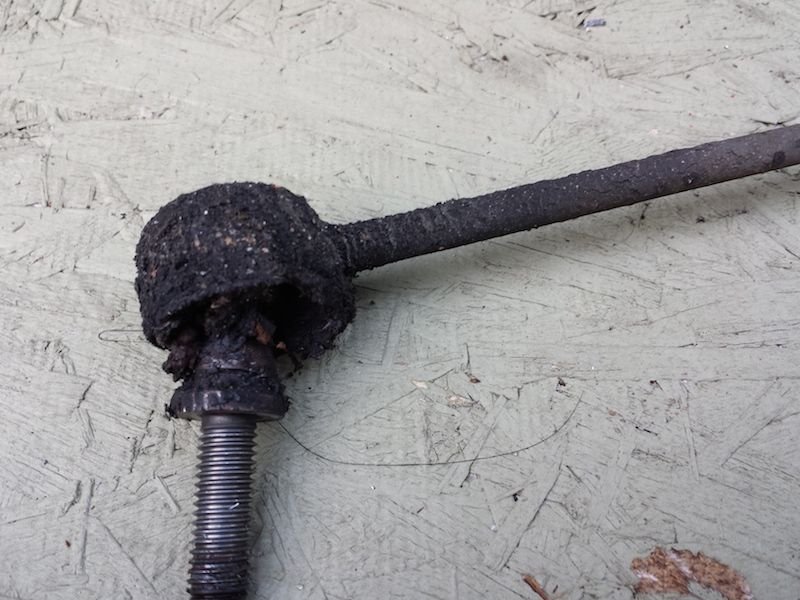

Sway bar link
New Sway bar link

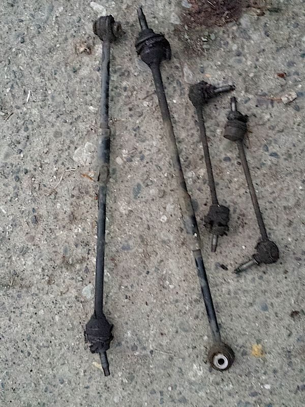

Second Torque rod inboard end

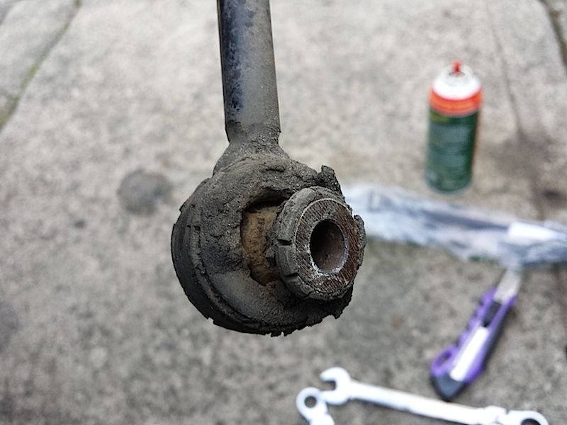

Second Torque rod outboard end
Other drag link
Pile of junk.

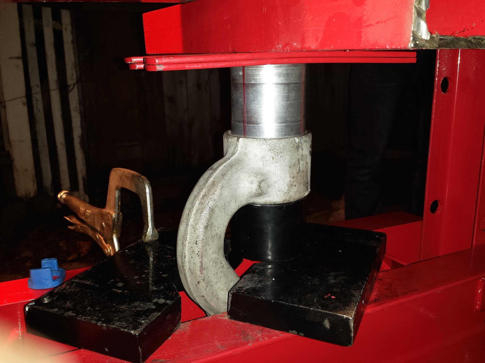

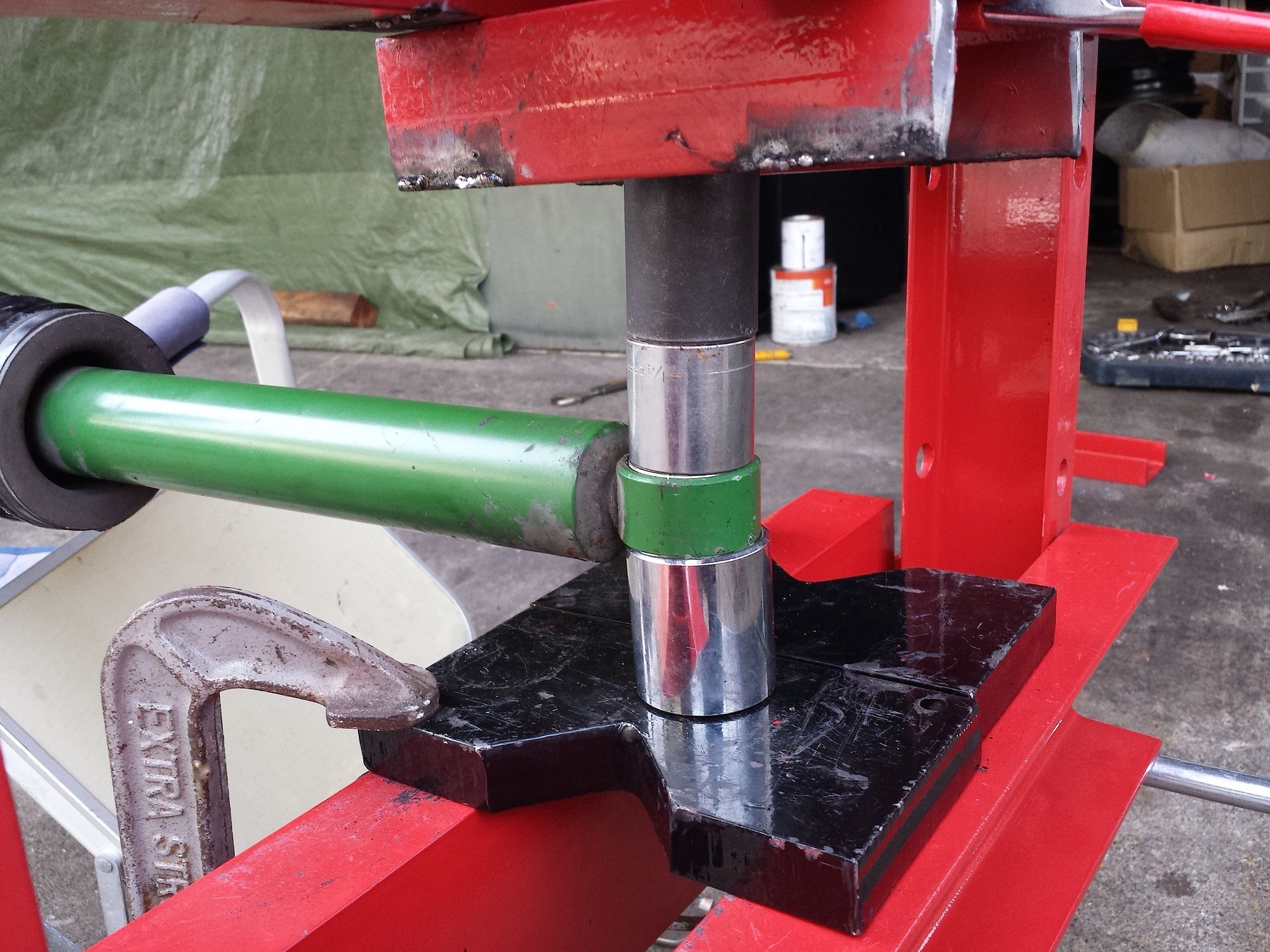

After a bit of research, found out I could buy an inexpensive shop press for less than what it would cost to pay someone to do all the bushes this car needed, so I picked it up and did it on my own.
Replacing front strut bushing.
I didn't think we would be able to manage the front lower control arm bushes, but we did.
Second front lower control arm bush going in. A lot of work but what a difference it makes.
I was able to do this work for less than 1/10 the price quoted me at Midas.

I wanted to show how bad these things can get, and no wonder it tracked so poorly. None of it was particularly difficult, although the press needed two guys with nimble fingers, a lot of big sockets, and for the front bushes a set of collars from a manual ball joint removal kit my buddy already had. The press is something you hardly ever need but I shared the cost with my buddy who will keep it once the car is done. I'm not a mechanic but I enjoy the sense of independence in not having to rely on others to fix the jag, not at the stratospheric prices I was quoted.

Night and day. Honestly, the worst effect was the rear torque rods. By allowing the rear wheels to flop in and out at the leading edges - by as much as in inch either way - the wheels reacted to uneven road surfaces by trying to turn the *** of the car in various random directions, independent from the front. In town it wasn't as noticeable, but on the highway it sure kept you on your toes.
