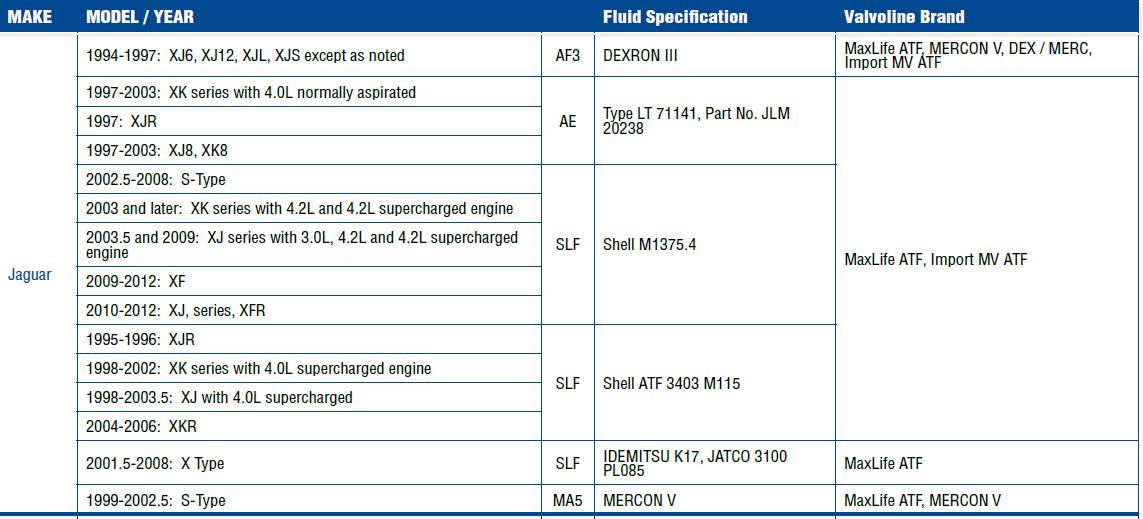

I use MaxLife ATF for almost all cars according to Valvoline.
Used it for Mercedes and my Jaguar. $20-25/ga
Attached Thumbnails Valvoline ATF for Jags, all years and models.-jag-valvoline-atf.jpg

I don't see any way it can meet those incompatible specs...
Old May 9, 2017 | 05:18 AM
Posts: 28,831
Likes: 11,290
Just looked at the Valvoline Guide, and MaxLife Full Synthetic specs do not include ZF Longlife etc.
Maybe OK for the 5 speeds and 4 speeds of old, but not the 6 and 8 speed units.
