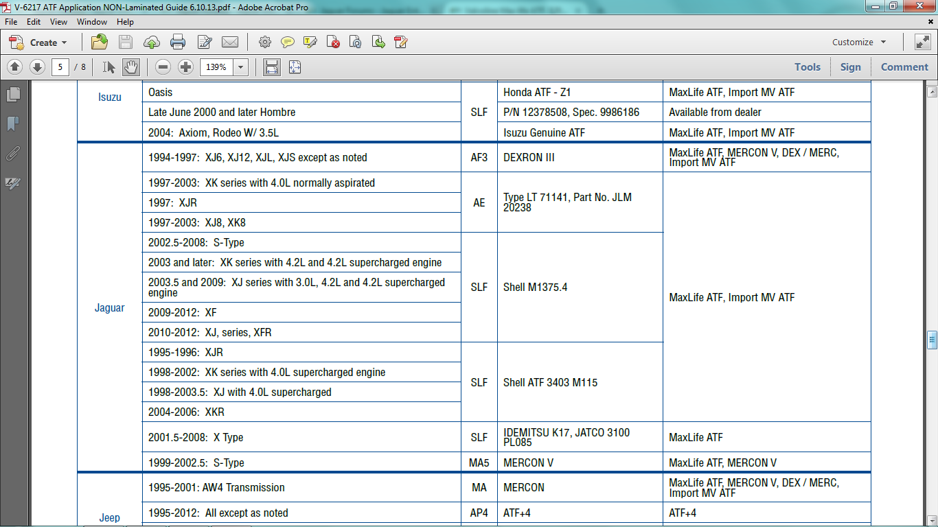

link

PDF in post 11

The PDF does claim it's suitable for the ZF.
2002.5-2008 S-type Maxlife, see right column
